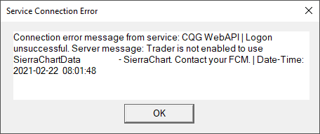

Also still struggling with the switch and writing with AMP support since countless hours. Looks like they just did not activate the label for the SC connection Mode with SC data according what I found on SC board but they just don't get it.
No way I can log in with the new CQG credentials I received. Getting the attached error message. Trader is not enabled to use SC data.

It's not about getting data for a specific chart as I'm not able to even get a connection. I know that I need to change the symbol mapping from TT to CQG after I got connected but I'm struggling with the first step. Pretty sure my AMP account is missing the private flag to use SC data as I read in your documentation and also pointed AMP support and trade desk to this issue. They keep saying everything is configured correct on their end but cleary, the log shows the error I get from CQG Web API.
CQG WebSocket | Web socket state is now open. | 2021-02-22 14:05:15.074
CQG WebAPI | WebSocket connected. | 2021-02-22 14:05:15.074
CQG WebAPI | Sending market data logon message. | 2021-02-22 14:05:15.075
CQG WebAPI | Logon unsuccessful. Server message: Trader is not enabled to use SierraChartData - SierraChart. Contact your FCM. | 2021-02-22 14:05:15.547
CQG WebSocket socket (1) | CloseSocket call. | 2021-02-22 14:05:15.553
CQG WebSocket socket (1) | 0 bytes remaining in receive buffer when socket closed. | 2021-02-22 14:05:15.553
CQG WebSocket socket (1) | Write in progress. Shutdown being delayed. PendingSize=0 | 2021-02-22 14:05:15.553
CQG WebAPI | Disconnected. | 2021-02-22 14:05:15.553
CQG WebAPI | Not reconnecting due to connection error condition. | 2021-02-22 14:05:15.553
CQG WebSocket | WebSocket closed. | 2021-02-22 14:05:15.553
CQG WebAPI | WebSocket closed. | 2021-02-22 14:05:15.553

nosast - Posts: 324
Attached is the error window while trying to connect.

User213840 - Posts: 3
I have the same problem as nosast. It also says Trader is not enabled to use SierraChartData when I try to connect with CQG login. Will see if AMP customer service can help.
[2021-02-22 20:40:31]
For any CQG connectivity issues you need to contact your broker. We do not help with those.
You can see the relevant error in the Service Connection Error box that pops up.
[2021-02-22 21:30:20]
nosast - Posts: 324
Seems like the guys fixed it. Reason: in myCQG I wasn't seeing any EULA to agree to. Once they showed up and I signed them I was able to connect.
