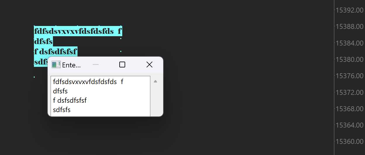

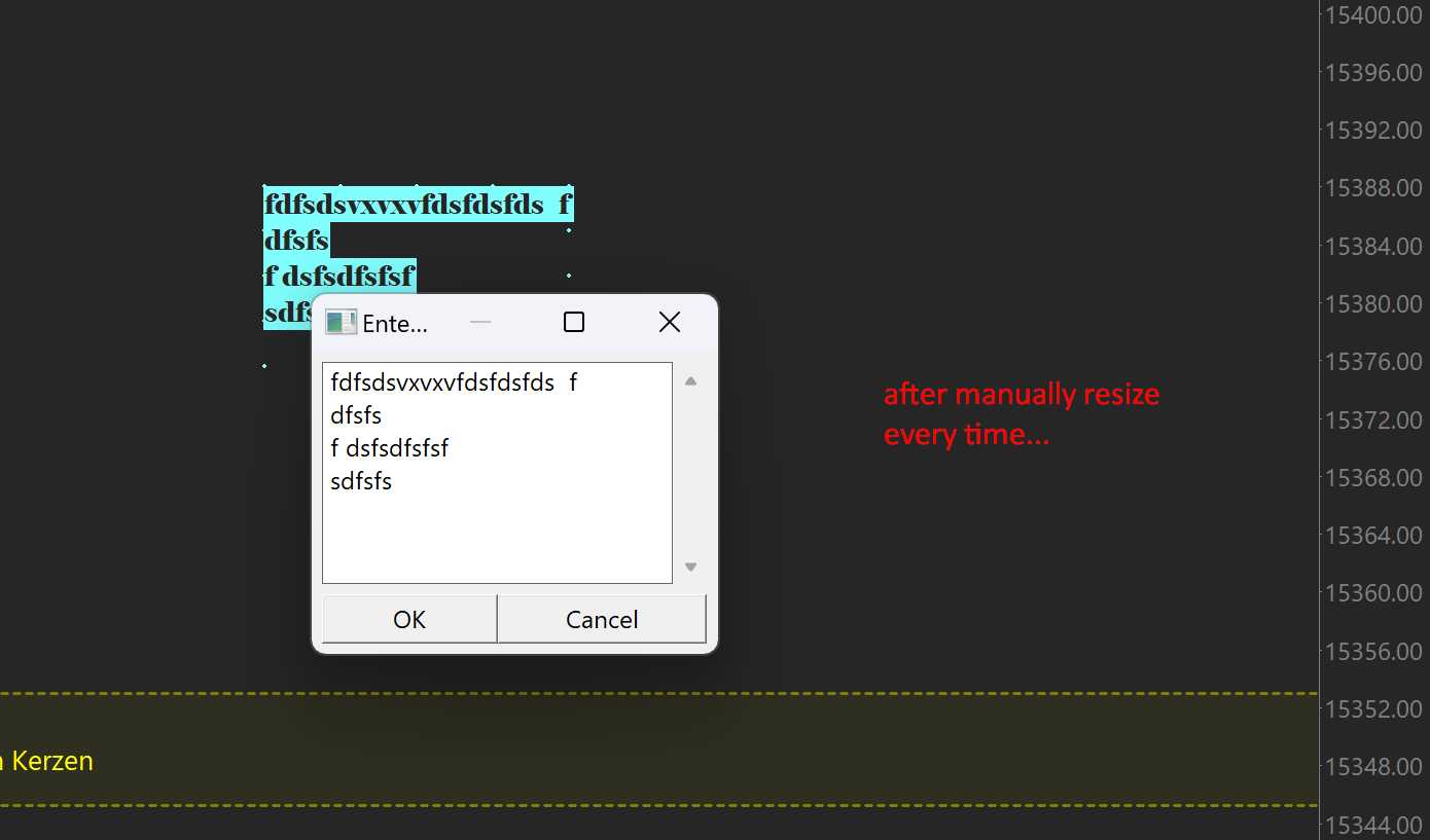

[2023-11-02 15:24:57]
User355493 - Posts: 27
I have the same problem with a "stationary text". Every time I want to change the text, the 2 buttons "OK" and "Cancel" are not visible. I have to resize the window larger each time....
Is there a solution for this, that SC remembers the previous size of the window ? Or is there a setting for it ?
[2023-11-03 14:56:48]
We will check on this.
[2023-11-09 16:42:42]
Example attached.... maybe it helps to understand the error
Date Time Of Last Edit: 2023-11-09 16:44:15
