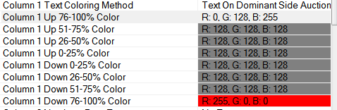

Hello, is it possible for you to add 1 or 2 options in colomn color ?
Because the maximum % is 76-100%, i would like 200-400%....100% is not enough to see real imbalance between the bid and the ask
imagecolors.PNG / V - Attached On 2014-02-25 21:18:41 UTC - Size: 12.04 KB - 690 views

This is done by adjusting the Column # Compare Thresholds:
https://www.sierrachart.com/index.php?l=doc/doc_NumbersBars.php#ColumnCompareThresholds
When you specify numbers greater than 1, then they still remain as percentages when using the "Auction" Text and Background coloring methods. The documentation is going to be updated to clarify this.

[2014-02-25 21:37:11]
TradingMarketProfile - Posts: 120
Ok thanks but it's difficult for me to understand very well..
So if i want 200% différence, what number i have to add, please ?

Al SC Developer - Posts: 434
The doc is being updated today. Use a value of 200 to get 200%.
