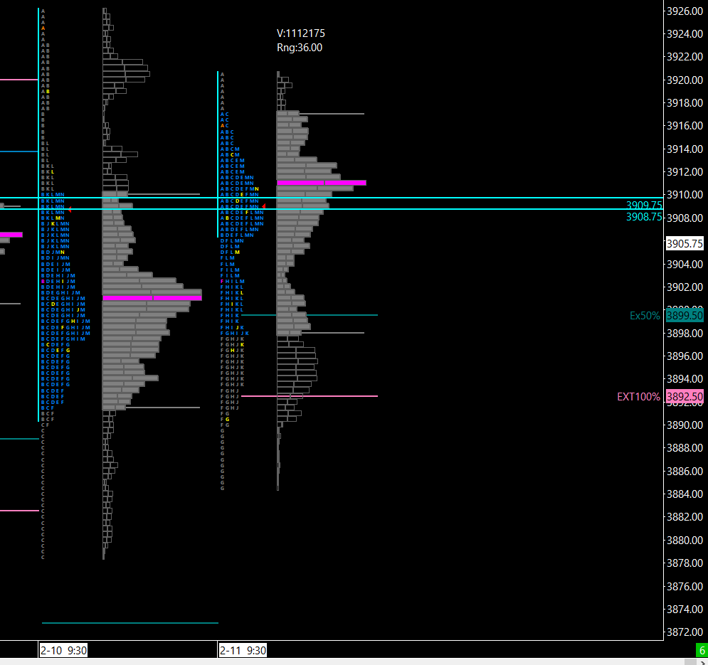

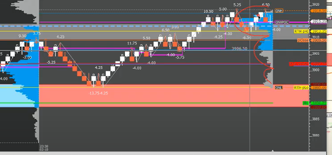

User841879 - Posts: 6
Hello I attached how it looks in my friend (different software)talking about the profile on the left, you can see that the pclose is on 3909.50 and mine is 3908.75 and his value area high is around 3913.50 and mine is on 3910. I did what is on the link you send but it's the same. What can i do?

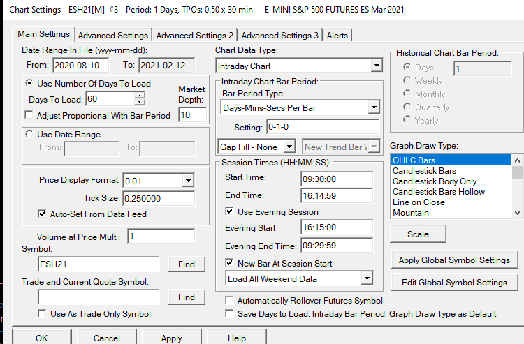

[2021-02-14 14:20:59]
Attached how the session times set for me. Is that ok? i did everything , i'm using Gain data real time . still it's shows diffrently
imageChart_Settings_ESH21_M_3_Period_1_Days_TPOs_0.50_x_30_min_E_.png / V - Attached On 2021-02-14 14:19:29 UTC - Size: 53.71 KB - 347 views
