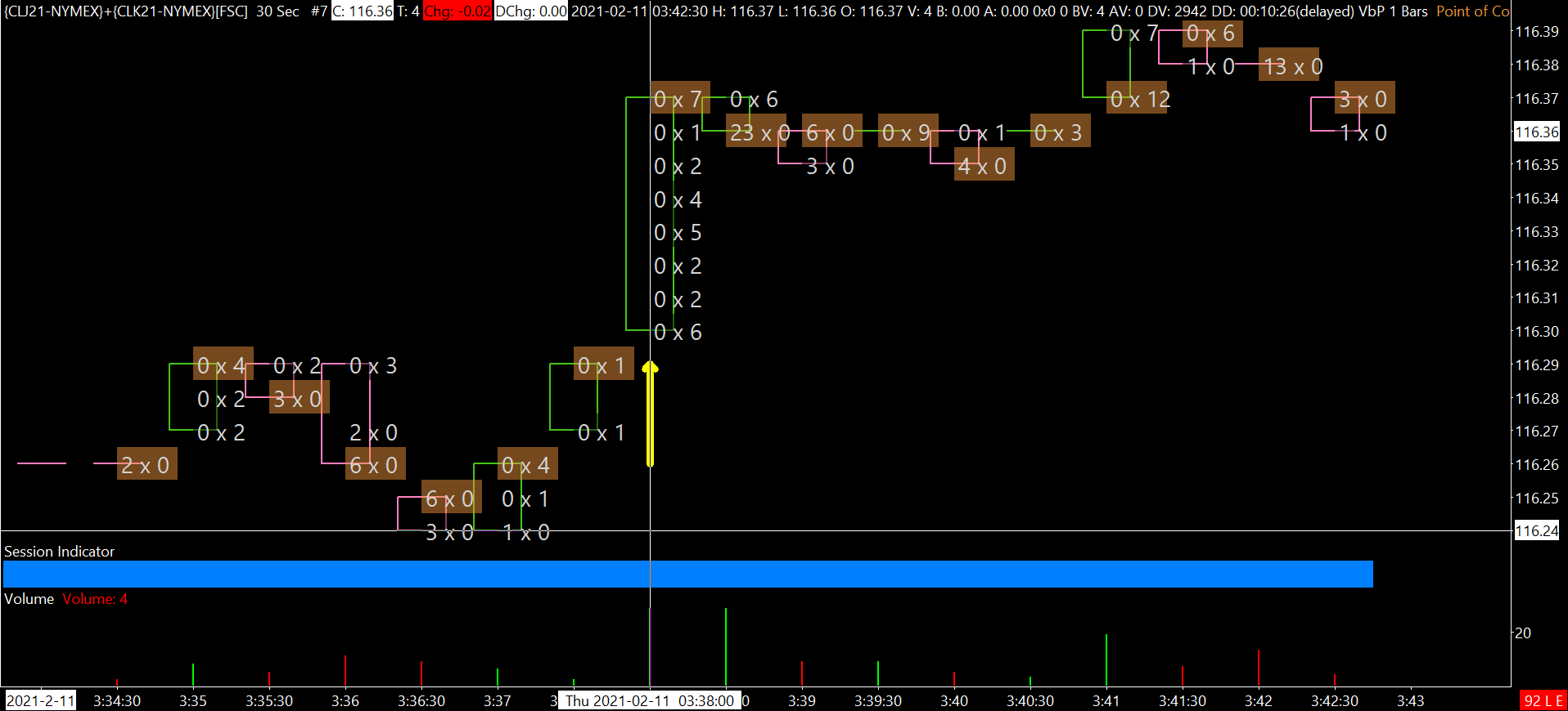

This is the combined chart CLJ21+CLK21 below, if you look at the bar highlighted with a yellow arrow. The total volume is 29 for the combined instruments. And notice everything is traded at the offer. The timestamp is 0338, on 30 Sec bars
http://www.sierrachart.com/image.php?Image=16130394953.png

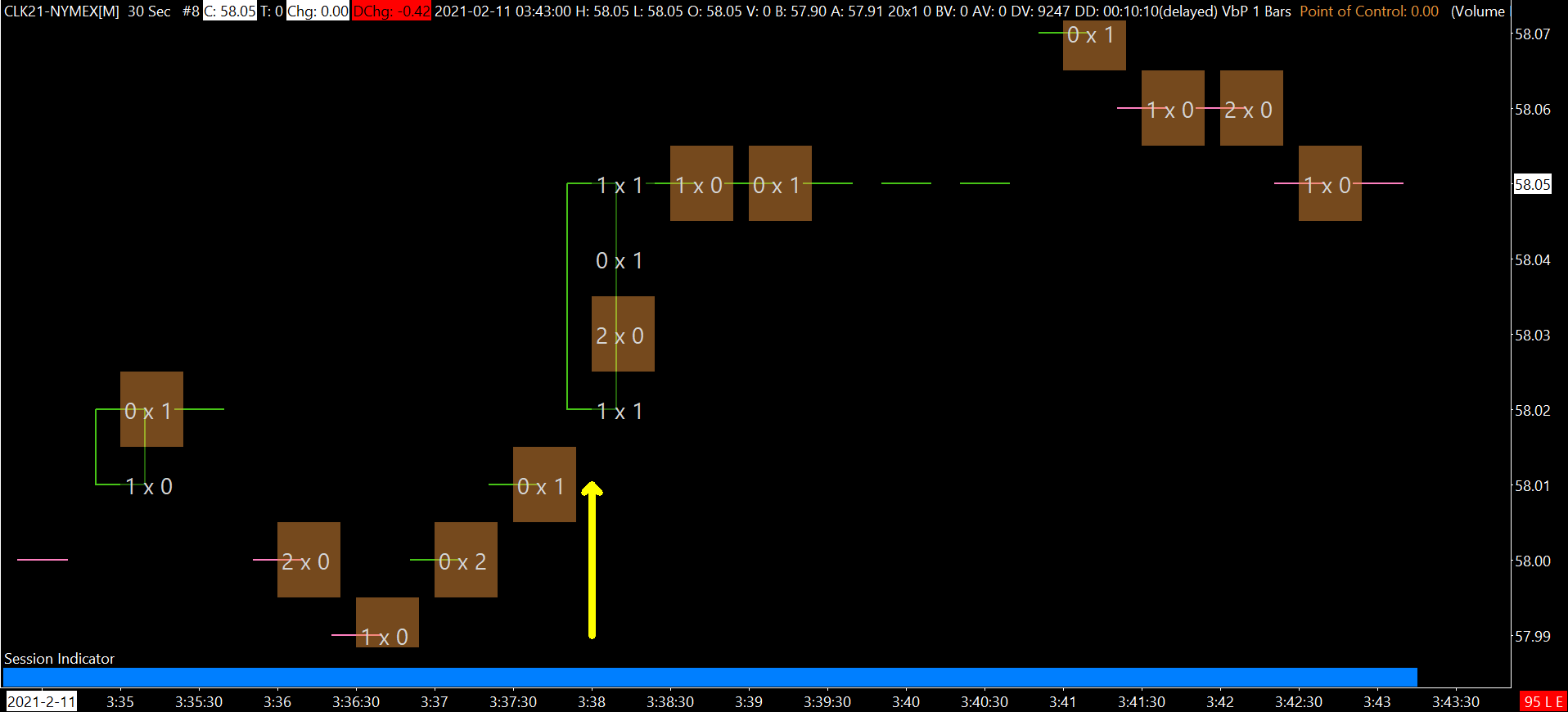

This is the CLK21 image http://www.sierrachart.com/image.php?Image=1613039664425.png
notice there are some bids and offer trades for the timestamp 0338. Total Volume her is 7 Total volume with 4 Bid and 3 Ask

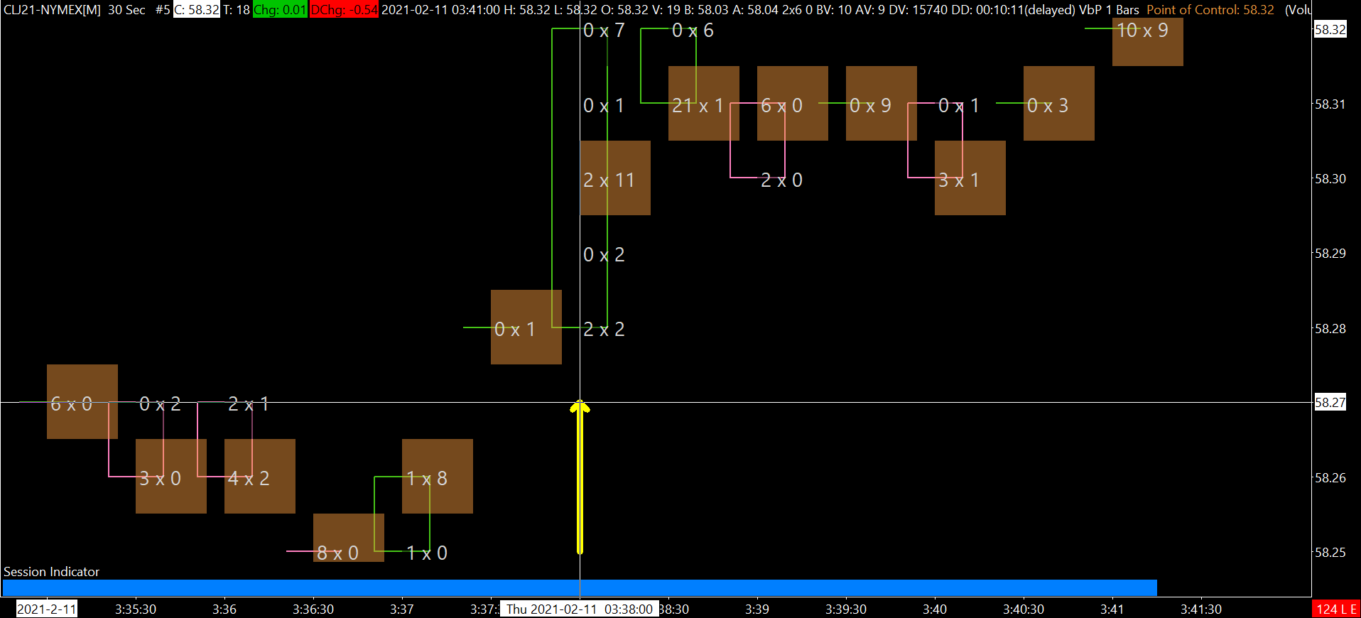

Then this is CLJ21 http://www.sierrachart.com/image.php?Image=1613044169956.png
The same timestamp the total volume is 27 with 23 traded at the ask and 4 at bid
So there is a discrepancy in the total volumes as well as the actual split between bids and offers on the combined instrument.

You definitely cannot use the Numbers Bars study with a custom calculated symbol. That is not going to work properly and it is not something we would help with.
