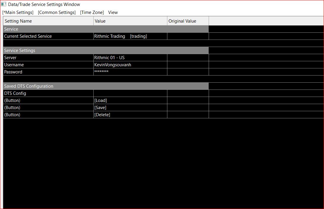

I try to connect my Trading account with my Sierra Chart -- but I actually can not get IN >> do you know why ?

You need the Rithmic Bridge Files. Refer to the information here:
Also, be aware that we do not offer any technical support for Rithmic. We recommend using the Sierra Chart Order Routing Service instead. You will find the information for this service here:

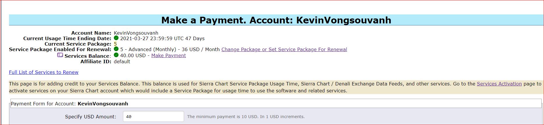

Hi support
Did you receive the payment of 36usd ? Adv5 platform >>
I can't connect my real Trading account from the Broker AMP
Thanks for your help

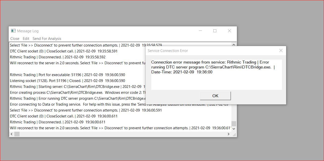

KevinVongsouvanh914 - Posts: 5
Hi support
I already funding my account - but can not IN on the trading information LOG ?
Thanks to help
Regards
imagemessages Failed.JPG / V - Attached On 2021-02-09 18:36:54 UTC - Size: 132.65 KB - 367 views
imageaccount funding 40.JPG / V - Attached On 2021-02-09 18:36:59 UTC - Size: 121.39 KB - 356 views
imagetrade-service.JPG / V - Attached On 2021-02-09 18:37:12 UTC - Size: 82.96 KB - 351 views

John - SC Support - Posts: 47939
You have not installed the Rithmic Bridge Files. Again, you will find them here along with the information on where to install them:
