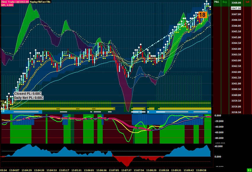

Since I have downloaded the new version, I have problems with the trading activity log and P/L display in the chart.
In Chart: P/L should shows "0.68C after the trade" instead of P/L "$80 - commission" . The P/L display during the trade is correct !
And the trade activity log shows points only. It is set for Currency
please advice
imagechart for Replay-backtest.jpg / V - Attached On 2014-02-23 15:42:47 UTC - Size: 241.18 KB - 659 views

Version 1077 works without problems. Only version 1094 gives me the problem.
I run another test trade with 1094 after working through the helpdetails77.
As mentioned no change.
During the trading process the P/L shows the accurate "win - commission"
and when the trade finishes the value changes.

G. Thierstein - Posts: 7
NQZ3 it replays but counts wrongly
NQZ4 and NQZ14 do not replay at all
[2014-03-02 20:42:01]
1. Update Sierra Chart to the current version.
2. For correct Profit/Loss values only use the symbols that you currently see listed in File >> Find Symbol.
You need to have selected the correct Service in File >>Data/Trade Service Settings which correspond to the symbols you are using.
3. In the case of the Sierra Chart Historical Data Service, for futures contracts, the years are two digits. Only use those symbols. There are no Symbol Settings which are necessary for correct profit/loss calculations, for single-digit years.
4. We are not quite sure what the replay problem is you are having. For the documentation for this, refer to:
https://www.sierrachart.com/index.php?l=doc/doc_ReplayChart.html
5. Once again, if you continue to have a problem, review the information given here and make sure you have the proper Symbol Settings applied to the chart:
http://www.sierrachart.com/index.php?l=doc/helpdetails77.html
Date Time Of Last Edit: 2014-03-02 20:42:29
