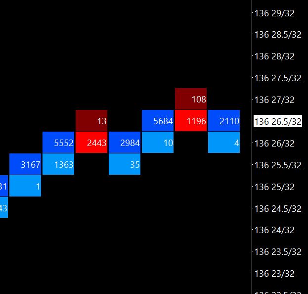

Please see attached screenshot.
I am using Number Bars and you can see that it displays total volume at a price. However, is it possible to see AT A PRICE, how much of that total volume was selling the bid and buying the offer?
imageSampleNumberBars.jpg / V - Attached On 2021-01-21 18:15:01 UTC - Size: 42.24 KB - 404 views
[2021-01-22 10:57:21]
Yes. It is controlled with this Numbers Bars study input:
Numbers Bars: Column # Numbers Bars Text (Column # Numbers Bars Text)
You will want to use:
Bid Vol x Ask Vol
[2021-01-22 17:24:57]
User315851 - Posts: 27
Thanks for the info. I had success with your recommendation. Final question, when using the "Numbers Bars Avg Volume/Price", ...is there a total volume per range instead? I do not want the average, I want to see total. Thank you
