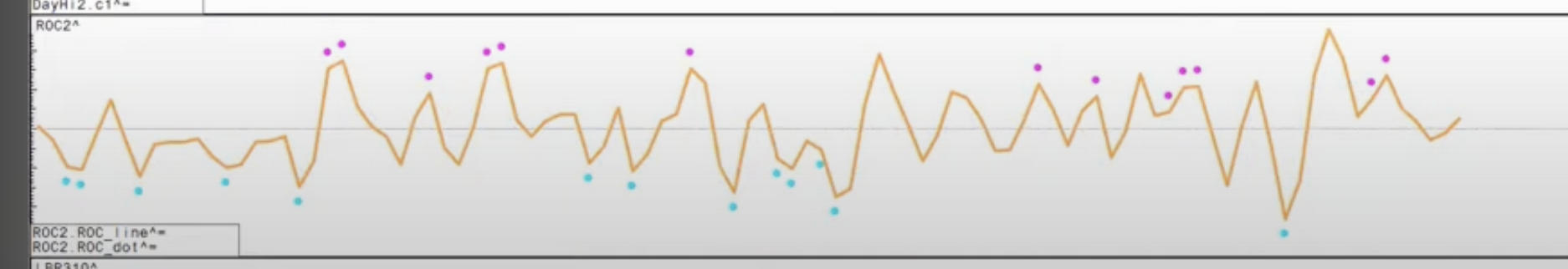

[2024-04-10 03:13:18]
User624595 - Posts: 264
But if you just need to subtract the data, then that can be easily accomplished by using the Spreadsheet Formula and entering the following formula: = C[-2] - C[0]
Is there a way to put this into an ROC study that plots a subgraph on the chart, something like this?
imageROC Line Subgraph.png / V - Attached On 2024-04-10 03:13:03 UTC - Size: 332.77 KB - 283 views
[2024-04-10 15:21:12]
Yes, you can do this. Setup the Spreadsheet Formula, or whatever study you are going to use, and set the ROC study you are going to use to have the "Based On" set to the "Spreadsheet Formula" and then make sure the "Input Data" is set appropriately. Refer to the following:
Chart Studies: Settings and Inputs Tab >> Based On - Basing a Study on Another Study
[2024-04-10 16:49:13]
Thank you, is it difficult you could put put this formula directly into a Sierrachart ROC study without using spreadsheets?
[2024-04-10 17:07:47]
This is not something we would do. What you are asking for is a specific formula to go into the ROC study. Sierra Chart is setup to allow you to reference other studies within a study, therefore giving you the ability to do what you are wanting.
