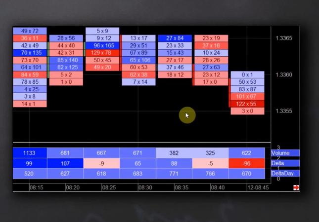

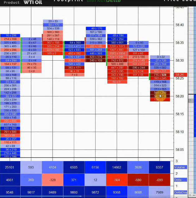

I've been watching a course that was using MarketDelta and I'm trying to copy that Footprint setting. I spent few hours looking into the documentation you provide but I'm still confused and didn't find what I was looking for.
I would like to set it like this.
When Delta is negative for a price:
-colour red (light red, normal red or dark red) for a price
-depending of the total volume within that negative delta price box (Bid + Ask) to display a particular type of red(light, normal or dark)
However those 3 nuances are not mandatory in each rotation. (i.e. there can be rotations only with light colours(low volume) or there can be rotations with only dark colours)
I don't know if I explained this well, hope the attached photos will give you a better understanding.
Thanks!
Alex
image111.png / V - Attached On 2021-01-20 13:38:01 UTC - Size: 443.22 KB - 589 views
image222.png / V - Attached On 2021-01-20 13:38:11 UTC - Size: 270.07 KB - 469 views
