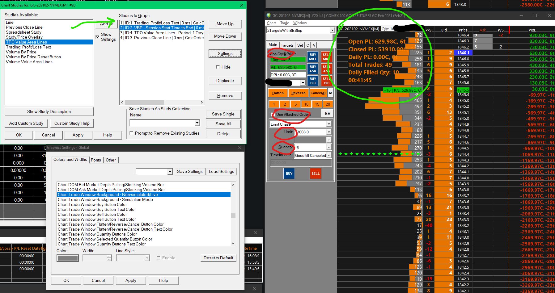

See attached image of my DOM setup for illustration.
1 - I've spent an embarrassing number of amount of hours trying to get the study Trading:Profit/Loss Text to show on top of the VBP study with no luck. As an example I can Move Up or Move Down <Study #3 TPO Value Area Lines> and it will show above or below VBP, but not Trading:Profit. I've also messed with lots of settings like; Draw Study Underneath Main Price Graph, Changing chart regions etc.
2 - Can you change the text color that is circled in red? I can't find the setting...
Thanks!

Thoughts on this? It's either broken or I'm idiot (likely) because I tried again and can get any other study to display above the VBP but not Trading:Profit/Loss Text. Running latest version of SC

The Trading Proft/Loss Text (and other studies that create text like that on the graph) are actually using Drawings. Therefore, in order to get the text on top, you need to make sure that the following setting is NOT enabled:
Chart Settings: Draw Non-Highlight Chart Drawings Underneath Main Graph and Studies (Chart >> Chart Settings >> Chart Drawings menu)
You can change the color of the text by changing the Subgraph color on the study. Refer to the information here:
Chart Studies: Subgraphs Tab >> Color

Thank you so much that was driving me crazy!
