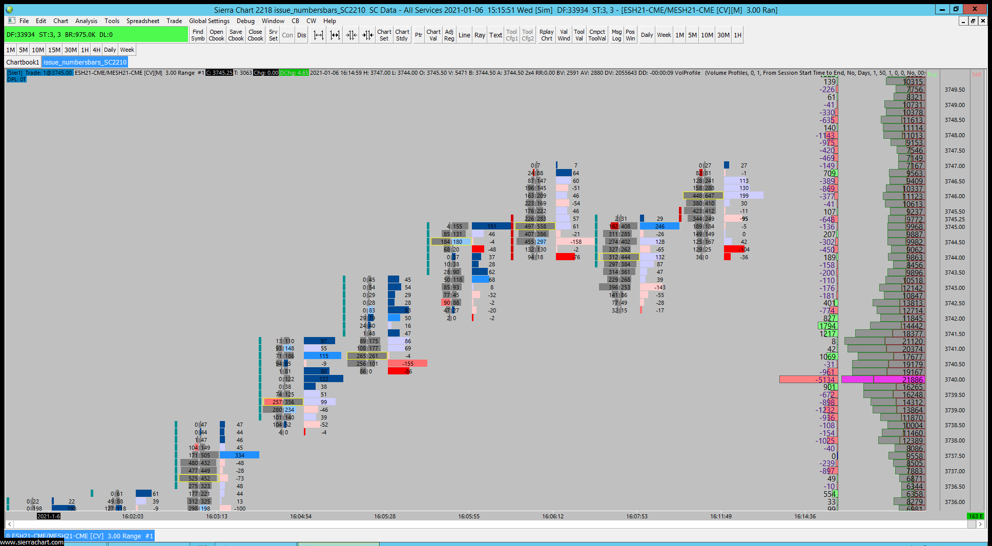

After update, the numbers in the footprint chart are only shown in decimal in one chart. Another chart works fine. What could that be?
imagebug numbersbar.png / V - Attached On 2021-01-06 18:56:40 UTC - Size: 202.5 KB - 356 views
[2021-01-06 20:17:27]
John - SC Support - Posts: 48419
Please attach a chartbook containing the chart that is not showing properly following these instructions:

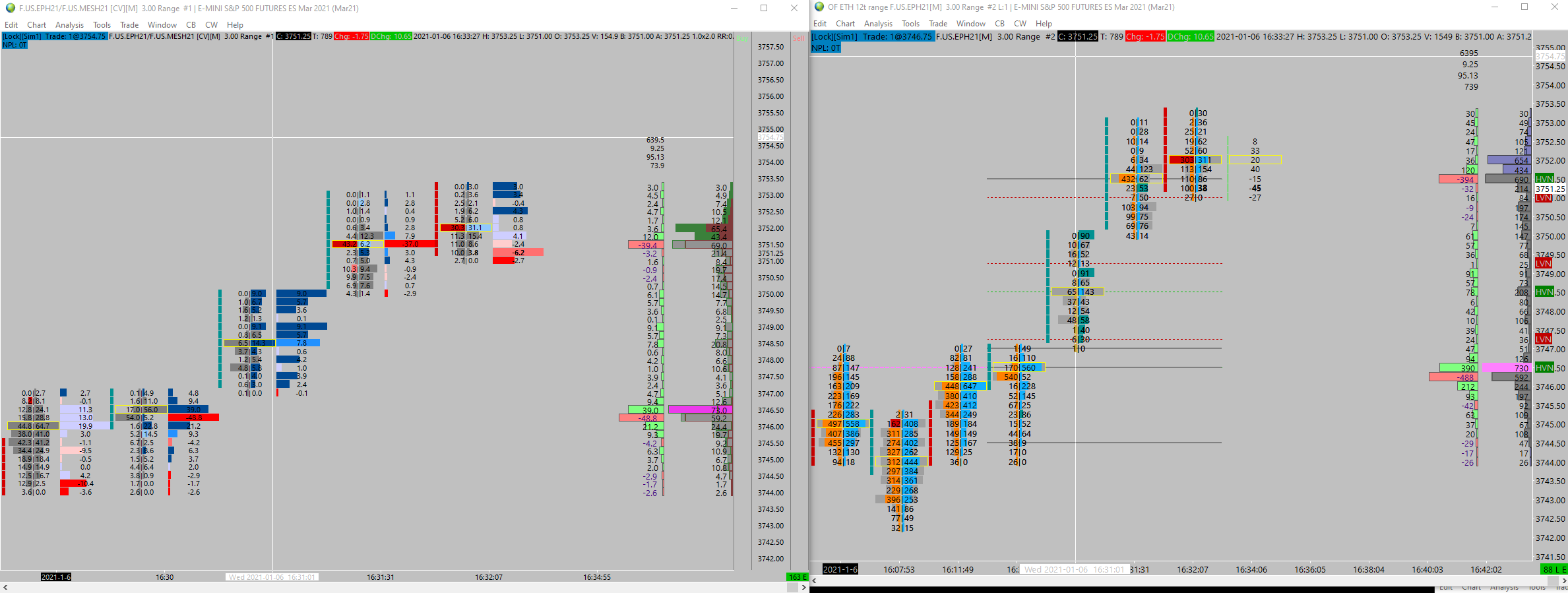

I added the second (correct) chart in the CB and see this screenshot:
attachmentissue_numbersbars_SC2210.Cht - Attached On 2021-01-06 21:34:41 UTC - Size: 16.09 KB - 450 views
imageissue numbersbar2.png / V - Attached On 2021-01-06 21:35:17 UTC - Size: 164.42 KB - 391 views
[2021-01-06 22:01:57]
Honestly, we have no idea why this is happening. It's like there is a Volume multiplier of 0.1 being applied. And whenever we pull up the chart on our end, everything looks fine.
The only thing we can suggest is to save the Studies as a Study Collection, then start a new Chart and apply the Study Collection and see what happens.
Refer to the information here for Study Collections:
Study Collections
[2021-01-06 22:20:10]
Make sure the Volume Value Format setting is set to 1 for the chart:
Chart Settings: Volume Value Format (Chart >> Chart Settings >> Symbol >> Symbol Settings menu)
Date Time Of Last Edit: 2021-01-06 22:20:21
[2021-01-07 07:31:14]
Marc@SC - Posts: 13
Many thanks. Post # 7 was the right hint.
