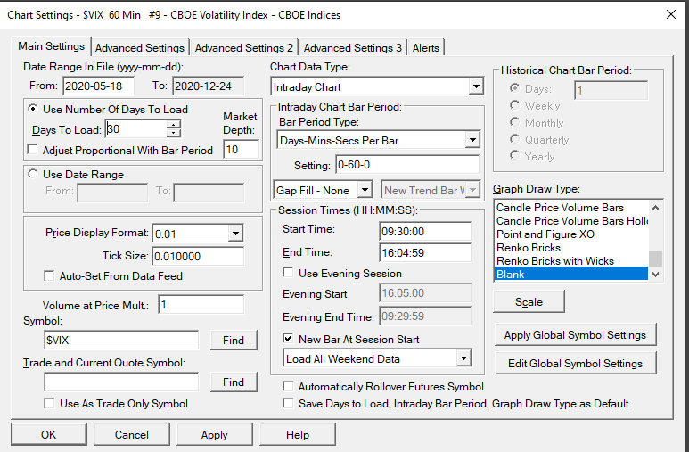

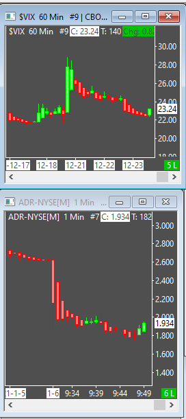

I have been using $VIX chart for a quite while and it simply stop working. You will be able to see in the picture attached that stopped on 12-23.
Could you please help me to figure it out what could be happening ?
I am also attaching a picture showing another indicator : ADR-NYSE that I also use and is running without problems

[2021-01-06 16:19:45]
John - SC Support - Posts: 48419
There was a change by the CBOE where their historical data is no longer available for free. Therefore, we are no longer able to offer that data at no cost. Refer to the information here:
Notice: Replacement for CBOE Indices Historical Daily Data
If you want to pay for the data feed, then you would need to use the Sierra Chart Exchange Data Feed and enable the CBOE Exchange. Refer to the information here:
Note that the ADR-NYSE is a Market Statistic provided by us, which is why that is still functioning properly.
