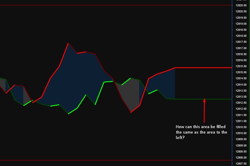

I use the Study Subgraphs Reference study and would like to know if it's possible to fill the are right of the last price bar in order to extend the fill all the way to the right edge of the chart? I've attached an image for reference.
imageSC Support Question.jpg / V - Attached On 2020-12-31 15:02:51 UTC - Size: 49.5 KB - 366 views

Use the Draw Style "Line at Last Bar to Edge".

The closest that would be available is to use the Draw Style mentioned in post #2, refer to:
Chart Studies: Subgraphs Tab >> Draw Style

Unless I'm missing something "Line at Last Bar to Edge" doesn't fill in the area between the moving averages. I am already using "Line Extend to Edge" which produces the same or similar result (a horizontal line).
It would be great if something was implemented that would allow this area to be filled in.
You are right. That is not supported.
