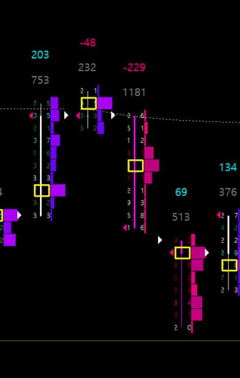

[2023-08-26 10:30:31]
User344477 - Posts: 4
HI, I had a same concern but in this i would like to add a study in which i would like to see delta turn from negative to positive for example
if previous bar delta is -229 and next bar delta is 69, study must suggest that delta spike more than 100%
I have tried to upload the image as well for example
imagedelta spike image.jpg / V - Attached On 2023-08-26 10:29:50 UTC - Size: 17.95 KB - 351 views
