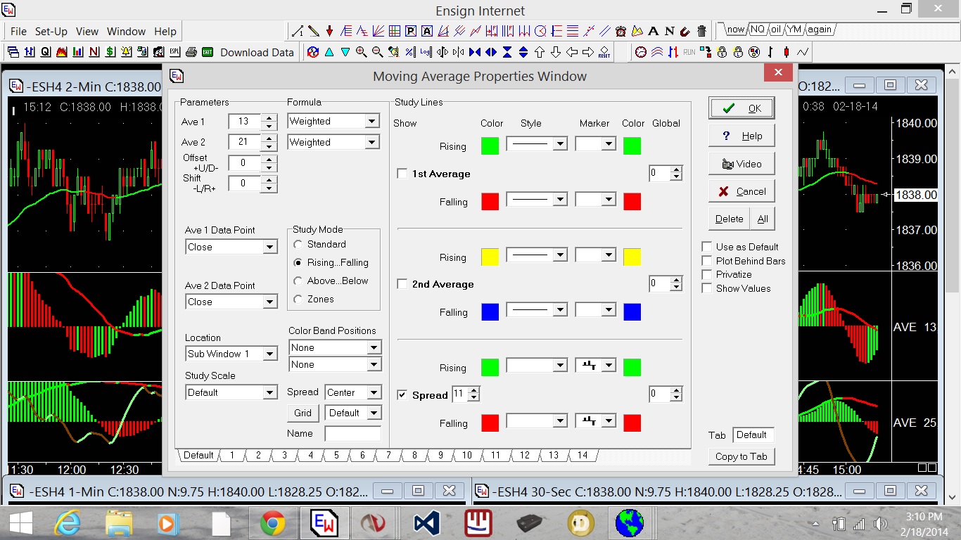

I am trying to make a/show a spread between 2 moving averages. It will be shown as a histogram and the colors will change rising/falling
imagespread.jpg / V - Attached On 2014-02-18 20:15:25 UTC - Size: 336.08 KB - 599 views

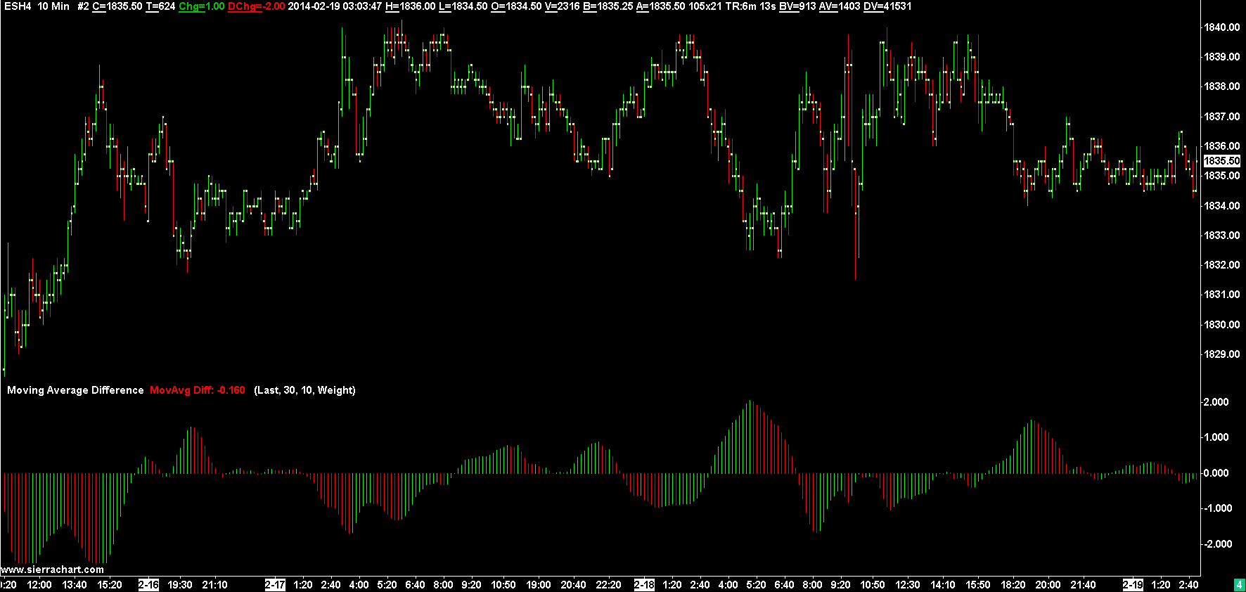

Have a look at the Moving Average Difference study:
http://www.sierrachart.com/image.php?l=1392797036887.png
We updated it in version 1094 to support the Moving Average Type input, so you can use a Weighted average
Update Sierra Chart by selecting Help >> Download Current Version.

I updated to newest version, found moving ave. diff, When I set it to weighted and hit OK, it reverts back to simple MA, could you check please.
[2014-02-19 18:02:40]
Remove the study from the chart and add it again. It should keep the Moving Average Type you are using.
