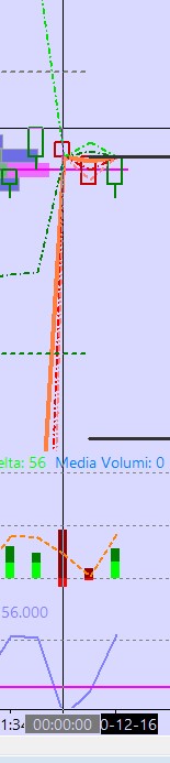

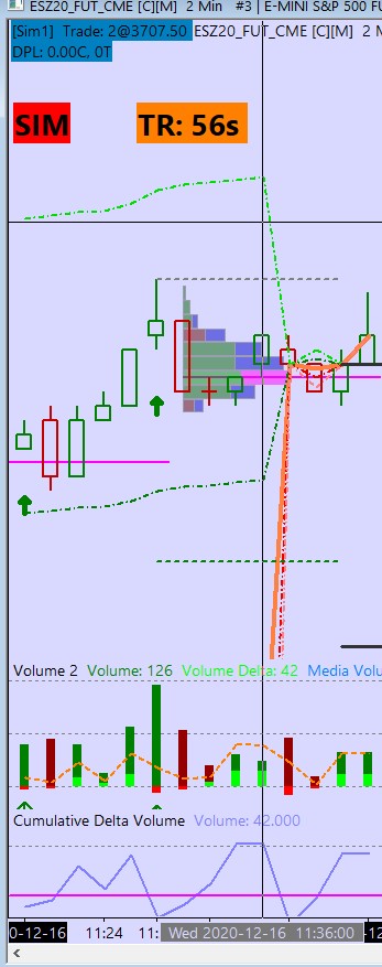

At each new candle is assigned the starting time of the day, on all tested symbols, in the images SP500
imageseq1.jpg / V - Attached On 2020-12-16 10:53:22 UTC - Size: 73.71 KB - 389 views
imageseq2.jpg / V - Attached On 2020-12-16 10:54:36 UTC - Size: 23.88 KB - 310 views

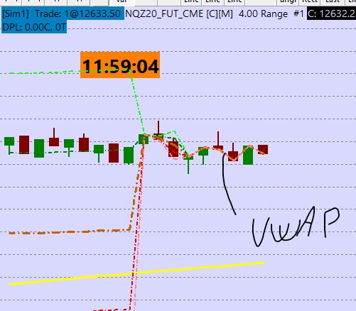

[2020-12-16 11:02:06]
GiovanniD - Posts: 41
after some time...
imageSP.jpg / V - Attached On 2020-12-16 11:01:43 UTC - Size: 49.62 KB - 370 views
imageNq.jpg / V - Attached On 2020-12-16 11:01:50 UTC - Size: 90.48 KB - 344 views
[2020-12-16 14:44:11]
John - SC Support - Posts: 48419
We are not sure exactly what you are trying to point out, but given the time showing zeros, we think what you may be experiencing is a problem with a custom study that has not been properly updated for the changes to the Date/Time variables. Refer to the information here:
*IMPORTANT* Notice: Custom Study Improperly Altering Time Scale of Chart
[2020-12-16 14:57:23]
no, from when I open SierraChart, all the new candles are all 00:00:00, so the vwap (the standard SierraChart study) go wrong.. but not only it, VpP for example go wrog too.
SierraChart becomes unusable..

[2020-12-16 15:17:27]
ok, solved..
problem with ACSIL compiler
