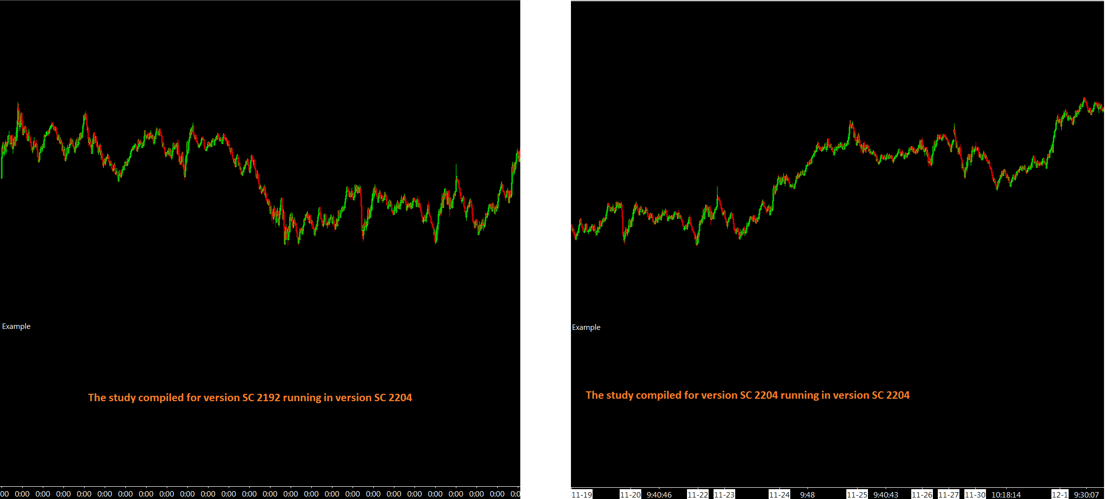

If you are the developer of a custom study, never change the elements of this array:
Nobody changes it. The statement above is incorrect.
This error occurs after updating the SC when the user does not recompile the library (or when use a third-party library that is not recompiled to a newer version). This is related to the change in SCDateTime functionality described in the 2195 notes.
https://www.sierrachart.com/index.php?page=doc/Whats_New.php#SCVer2195
Try this code below recompiled in version 2192 and open Sierrachart 2204. You will get a result with zeros on the axis. (attached file)
SCSFExport scsf_example(SCStudyInterfaceRef sc)
  if (sc.SetDefaults)
    sc.GraphName = "Example";
    sc.GraphRegion = 1;
    sc.AutoLoop = 0;
    return;
    for (int BarIndex = sc.UpdateStartIndex; BarIndex < sc.ArraySize; BarIndex++)
      if (BarIndex > 0)
        SCDateTime PreviousTradingDayStartDateTimeOfBar = sc.GetTradingDayStartDateTimeOfBar(sc.BaseDateTimeIn[BarIndex - 1]);
        SCDateTime TradingDayStartDateTimeOfBar = sc.GetTradingDayStartDateTimeOfBar(sc.BaseDateTimeIn[BarIndex]);
This is not to say that you are doing something wrong. You warned in advance that libraries should be recompiled.

imageLib_v2192_in_SC_v2204.png / V - Attached On 2020-12-04 20:36:37 UTC - Size: 36.94 KB - 724 views
