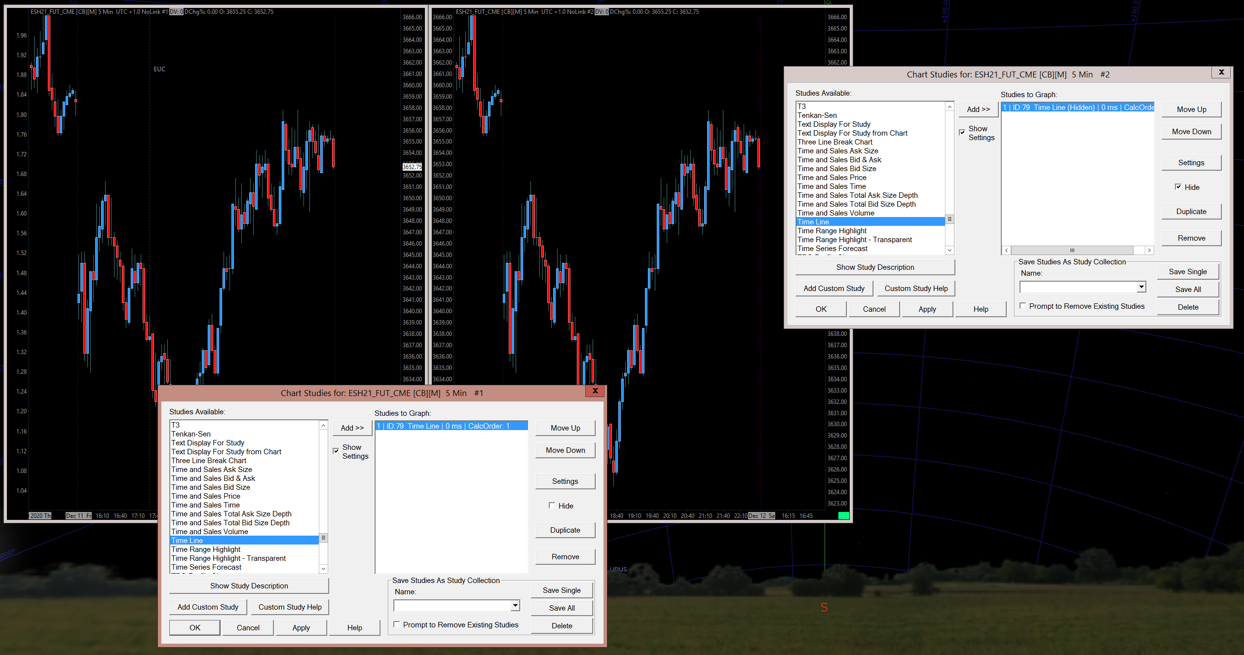

user8888 - Posts: 159
This began happening like one month ago or so.
I try to keep up with the latest releases. I'm in 2208 now. But happened aswell with the last 2 or 3 PreReleases.
It was working fine before.
Thank you.
imageTL.PNG / V - Attached On 2020-12-13 14:59:11 UTC - Size: 568.27 KB - 369 views

John - SC Support - Posts: 48419
We made some changes in recent releases so that the Left Side scale would work more appropriately. We do see this particular issue occurring and will get it fixed.
In the meantime, one way you can workaround this is to set the Scale for the Time Line study to Same as Region and then set the second subgraph (SG2) to Hidden.
Refer to the following for how to change the scale for a study:
Chart Studies: Settings and Inputs Tab >> Scale
And refer to the following for changing the Draw Style of a Subgraph:
Chart Studies: Subgraphs Tab >> Draw Style
[2020-12-18 20:57:02]
We have added a new option to the Scale window called Use in Left Side Scale. Unless this option is enabled, the study will not affect the left-side scale. By default, this option is disabled.
Therefore, for your particular issue, there will be nothing you need to do except update when the option is available. Since the Time Line study will not have this option enabled (by default), it will no longer impact the left-side scale.
This will be available in the next Pre-Release (v 2211).
