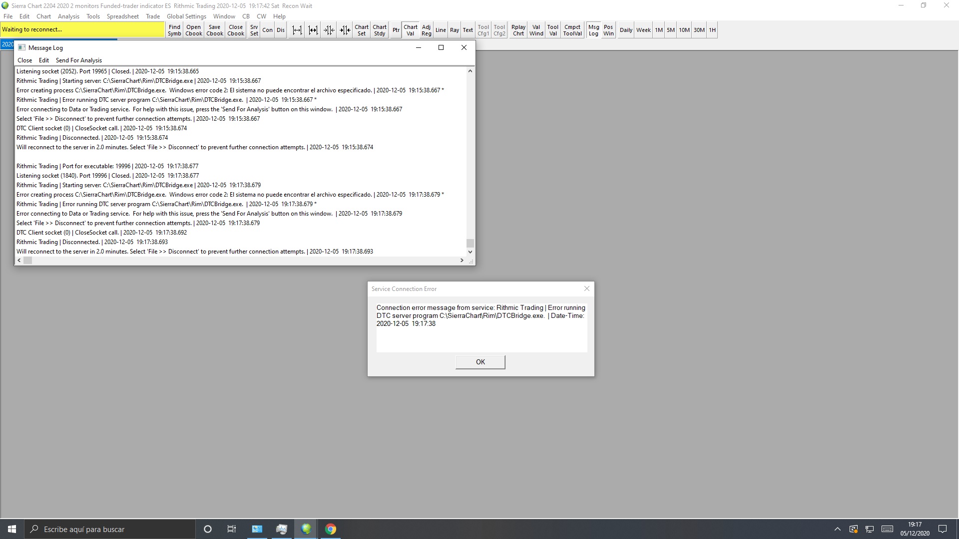

Dear Sirs,
This is just to say that I have a connection error when trying to connecto to my rythmic account for real-time data. I have just sent you a copy of the log automatically through the standard procedures.
I have also attached a copy of the log in .jpg format to this message.
As you can see, the error I get is specifically: "Error running DTC server program C:\SierraChart\RIM\DTCBridge.exe"
I would much appreciate your feedback in order to solve this issue.
With kind regards,
Ginés Evangelista
imageLog of connection error.jpg / V - Attached On 2020-12-05 18:27:11 UTC - Size: 298.12 KB - 437 views
[2020-12-07 00:46:04]
The problem is there are missing Rithmic bridge files. You can download then from here:
Rithmic Bridge Files
