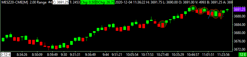

[2020-12-04 16:52:23]
User192329 - Posts: 3
ok i did what you asked.
If a bullish bar opens low and closes high, we expect the bar to be green.
As a bullish bar is forming, and price opens low and price is going up then we expect to see green.
Similarly for bearish bars.
http://www.sierrachart.com/image.php?Image=1607100393427.png
I've tried to submit an image but not sure if this is it.
