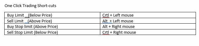

aseef - Posts: 55
I have enabled the one click order entry from the chart, there are preconfigured keys to order directly from the chart (picture attached of the default keys configuration). I would like to change as Crtl + left mouse click is a very risky key, if I by mistake used to while using the drawing tolls or price scale zoom in out etc it is triggering an order (very unsafe).
I would like to change it with combination like alt + shift + left click or etc.
Hope you get my point.

[2022-11-07 18:58:51]
Sierra_Chart Engineering - Posts: 25418
Configure the Chart DOM order entry as you require:
Global Trade Settings Windows: Chart DOM Settings
And then if you are using this option, how that works is explained here:
Chart Settings: Extend Chart DOM Across Entire Chart When Using Ctrl(Buy) / Shift(Sell) (Chart >> Chart Settings >> Trading menu)
If this still does not meet your requirements, then you cannot do exactly what you want. In which case just simply use the Chart DOM for order entry. It is that simple. And do not use the above option.
