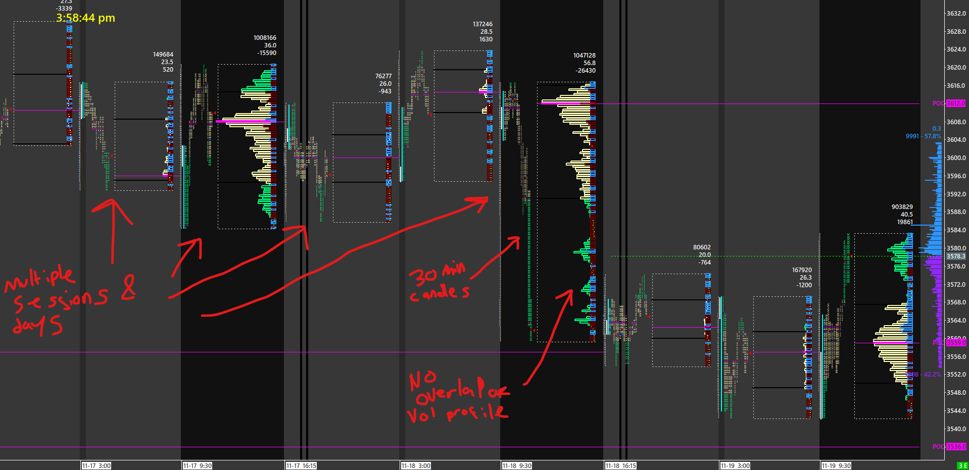

hello,
i have been asked this a handful of times by some other sierra users and i dont think there is functionality for this, although i could be wrong.
is there any way we can not have the volume profiles over lapped by the candles? many like to see the same timeframes from volume profiles every single day and week so we set 3 different profiles separating the parts of a 24hr period, for example.
however, the candles always overlap the volume profiles when you set them this way. it makes it very hard to see where the volume nodes are and makes this visual tool somewhat less effective. when you put the charts in a TPO format, this is ideal. the TPO DOES NOT overlap the volume profiles, even if you have multiple different profiles.
it would be nice to be able to have the volume profiles like this with different styles of charts and not just tpo.
is there a way around this and if not, would you guys consider supporting this?
thanks in advance
imagesierra support.png / V - Attached On 2020-11-19 17:22:57 UTC - Size: 84.8 KB - 1707 views

[2020-11-19 21:04:35]
User356762 - Posts: 37
the only one that would work would be the second option but i wouldnt be able to have multiple days of the individual volume profiles only the one day. with the first option it defeats the purpose of not seeing the candles and with the 3rd option it still seems to overlay on top if the volume profiles.
what i am trying to create is essentially a tpo profile chart but with candles instead of letters or boxes or horizontal bars.
i dont care if it has the functionalities of the profile chart like the sub studies; i am only interested in the way that the volume profile does not get overlapped by the price chart.
the benefit of this would be the ability to not only have 30min candles (or any other time variation) but to have multiple volume profiles with renko charts or point and figure or volume candles etc.
the multiple and individual volume profiles provide a really nice graphic of the markets recent history.
if i try to put a renko chart on this current chart then the renko bricks overlap the volume profiles instead of keeping them separate.
imageScreenshot 2020-11-19 140100.png / V - Attached On 2020-11-19 21:01:14 UTC - Size: 203.79 KB - 870 views
