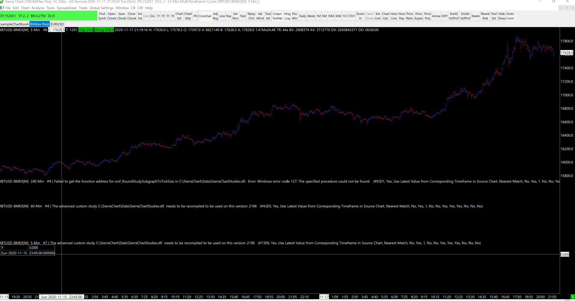

Dear Sierra,
I have downloaded the Current version of Sierra but no study can be shown. How can i solve the problems?

Are you referring to custom-built studies for Sierra Chart?
[2020-11-17 21:33:40]
MuUs! - Posts: 45
I think so. please see attached
imageNew Sierra.png / V - Attached On 2020-11-17 21:31:42 UTC - Size: 180.63 KB - 410 views

[2020-11-19 18:45:31]
Are you still having this issue?
We want you to install Sierra Chart again by selecting Help >> Download Current Version. When the installer starts wait about 10 seconds before proceeding with the installation.
If you still have the same issue, then exit from Sierra Chart and delete this file in the Sierra Chart folder:
C:\SierraChart\SierraChartStudies.dll
And then after that update again with Help >> Download Current Version.
Date Time Of Last Edit: 2020-11-19 18:47:01

Hello Sierra thank you very much I have been able to update the version of the software. However I am having trouble with "Scale In" "Scale Out" functionality.
