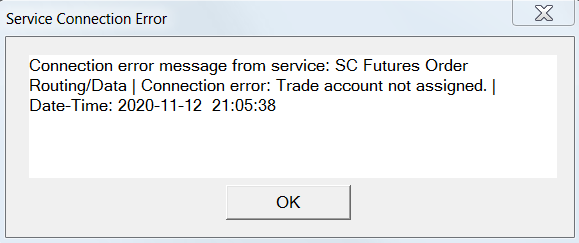

I follow your instructions to connect to the SC Future Order Routing/Data and as expected there is this Service Connection Error, please refer to the attachment !
Which indicates, that the connectivity of the Sierra Chart programm side is working, right?

[2020-11-12 21:31:23]
Yes definitely.

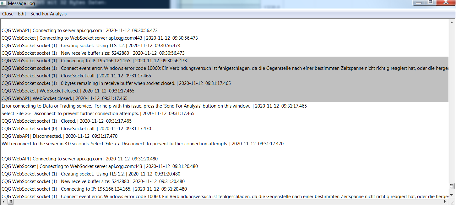

BUT in addition I opened an sub instance and the sub instance could load the latest chart data, but it does not refresh automatically. So if I close the sub instance and reopen again the latest data of all sub instance charts get loaded. However this does NOT work with the main instance! The sub instance message log are attached.
So it seems that in some way the data can be receive but not automatically and not with the main instance !
