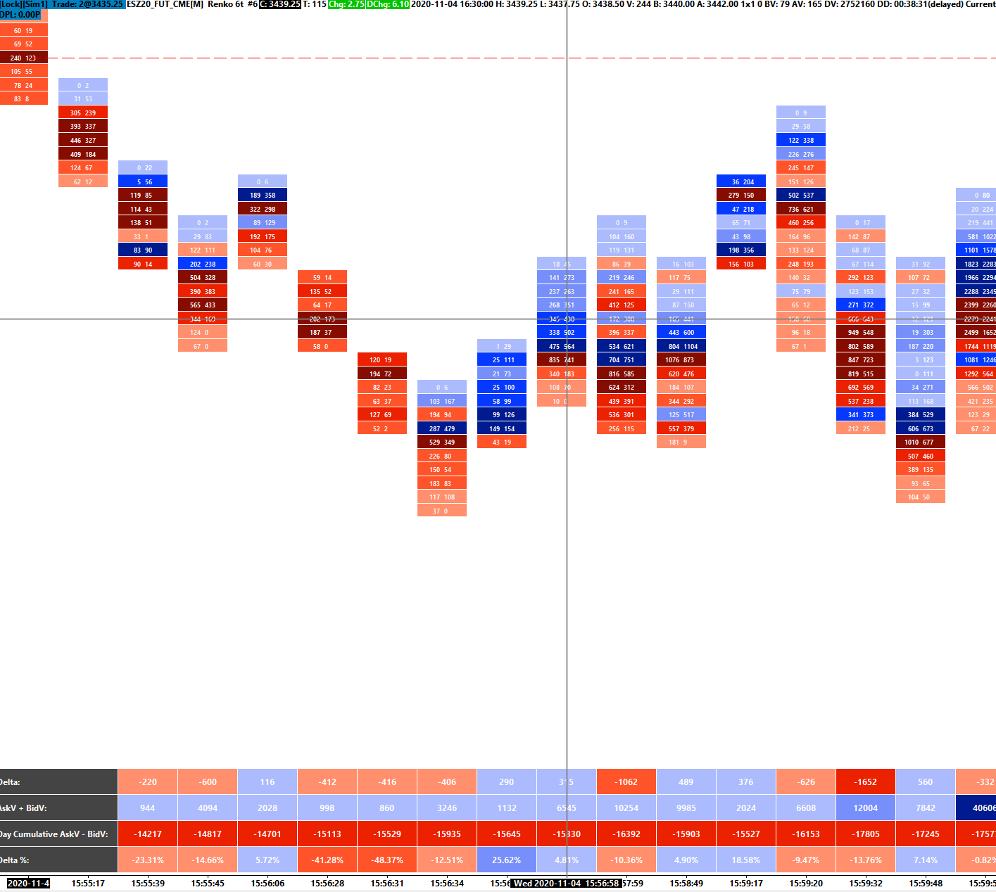

I'm wondering if it's possible to make so the shades on the number bars change color depending on:
1: Delta of the current column - determine the color of the current column (In this case, negative delta RED and positive delta BLUE)
2: Now when the delta has decided the color, we let the volume over the current session (daily) set the degree of color (ranges), so higher volume means darker RED/BLUE color.
I tried but I failed and right now it just take the volume of the current bar, and even if its low volume it will darken the area with "most" volume inside that bar.
I want it relative to the whole day, or something similar.
Is this, or something similar possible in SierraChart?
I got the idea from MarketDelta.
Please have a look at the attached images and it would maybe clarify a bit of what I trying to make.
Thank you!

[2020-11-05 15:23:28]
John - SC Support - Posts: 48459
You can do all of this in Sierra Chart.
1. There are a few different options for coloring the background based on the delta, but it sounds like the option of Based on AskVol BidVol Difference Percentage of Max Dominant Side is the one you want. Refer to the information here:
Numbers Bars: Background Coloring Based on AskVol BidVol Difference Percentage of Max Dominant Side
In this case, it is going to use the Up colors when the Ask is dominant and the Down colors when the Bid is dominant, but this is essentially the same as positive or negative delta.
Also look at the other delta options in that section to see if there is something that may be more of what you are looking for.
2. In order to adjust the color gradation based on the Daily volumes, refer to this setting:
Numbers Bars: Determine Maximum/Minimum Values for Coloring From
