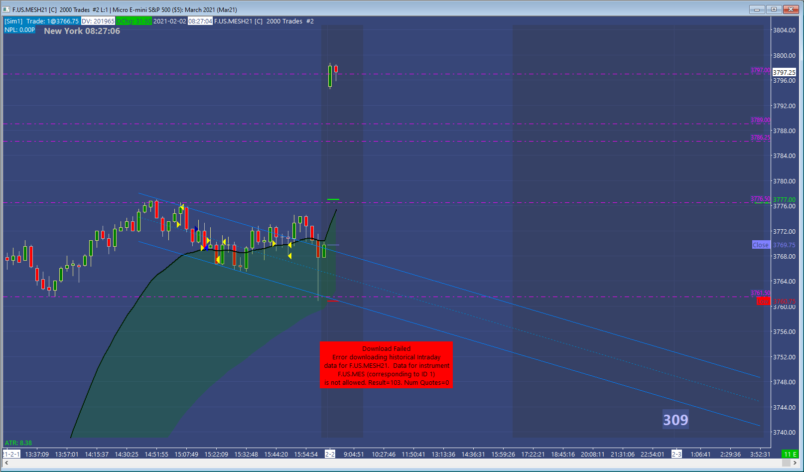

alphabettaoscar - Posts: 3
Bonsoir,
J'ai un problème avec le flux CME depuis début février 2021.
image2021-02-02_08h27_10.png / V - Attached On 2021-02-04 00:22:06 UTC - Size: 63.77 KB - 353 views

You are no longer using the Denali Exchange Data Feed, as it did not renew on February 1, 2021 since you did not have enough funds in your account at the time of the renewal. The charges process around 02:00 UTC, therefore when you added funds to your account on February 1, it was too late.
We see that you have tried to re-enable the exchanges, but were unable to do so, as you had not re-enabled the Exchange Data Feed itself. At this time, you should change your package to Package 10, which includes the data feed fee. You can then enable the exchange(s) you want. Refer to the information here for how to change your Service Package:
Sierra Chart Purchase and License Information: Renewing Access
As to the error you are getting, that is due to the fact that you have your Service set to CQG, so it is trying to get the data from CQG, but you are not enabled to get their data. Once you get the Denali Exchange Data Feed activated again, you will be fine. In addition, be aware of changes we have made to no longer subsidize historical data from CQG at this page:
Jan 1, 2021 Changes to Historical Data: Interactive Brokers, CQG
