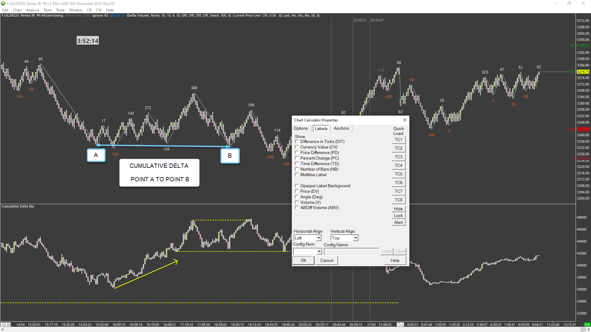

[2020-11-02 13:03:17]
User00111 - Posts: 111
How can I calculate the delta between two points "A-B" on a chart ?
A.
imageA-B delta.png / V - Attached On 2020-11-02 13:01:20 UTC - Size: 116.15 KB - 309 views
[2020-11-02 13:17:06]
Ackin - Posts: 1865
ABDiff Volume: When this option is enabled, then the sum of the differences between the total Ask Volume and total Bid Volume of the chart bars the Chart Calculator line is drawn across is calculated and displayed. This can also be referred to as the Cumulative Delta Ask Bid Volume. This is prefixed with ABV: on the Chart Calculator drawing.
Chart Drawing Tools: Chart Calculator Configuration
Date Time Of Last Edit: 2020-11-02 13:17:41

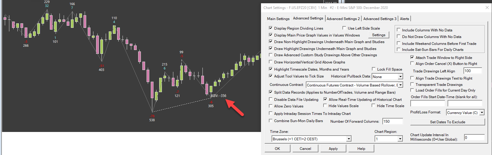

[2020-11-02 13:33:12]
Explain better.... likely there is some passage that I am wrong
Thx.
imageA-B delta.....png / V - Attached On 2020-11-02 13:31:39 UTC - Size: 78.51 KB - 376 views
[2020-11-02 17:32:42]
John - SC Support - Posts: 48459
Use the Chart Calculator tool and enable the option to display "ABDiff Volume". Refer to the following and also the link given previously by Ackin:
[2020-11-03 16:00:39]
Sorry John .... could you indicate the steps ... I'm failing ...
A.
[2020-11-03 17:19:03]
- Select Tools >> Chart Calculator.
- Draw your line between the points you are interested in.
- Right-click on the drawn line and select Chart Drawing Properties.
- Select the Labels tab.
- Enable the option to display the AskBidVolumeDiff.
- Select OK.

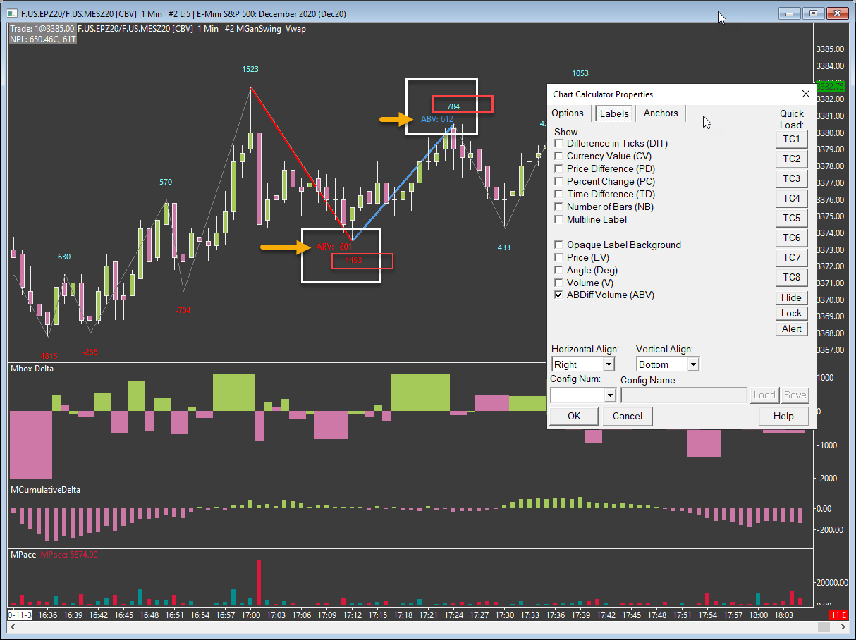

[2020-11-03 17:47:19]
I thank you ... so I did from the beginning ....
But the values are not correct ... now I want to understand if not corrected the AskBidVolumeDiff setup or Mbox ?
imageChart Calculator.png / V - Attached On 2020-11-03 17:47:11 UTC - Size: 71.18 KB - 345 views
[2020-11-03 18:11:25]
Ackin - Posts: 1865
AskBidVolumeDiff is definitely fine
I don't use MBOX but as far as I know it is only delta volume on bars in the same direction (MBOX Delta), The "M-ZigZag" will be same in this logic .
So if you want to compare you have to compare the same areas or display the volume below the bars (default sierrachart study ask / bid) and calculate it manually for one up / down movement .....
Date Time Of Last Edit: 2020-11-03 18:25:55
