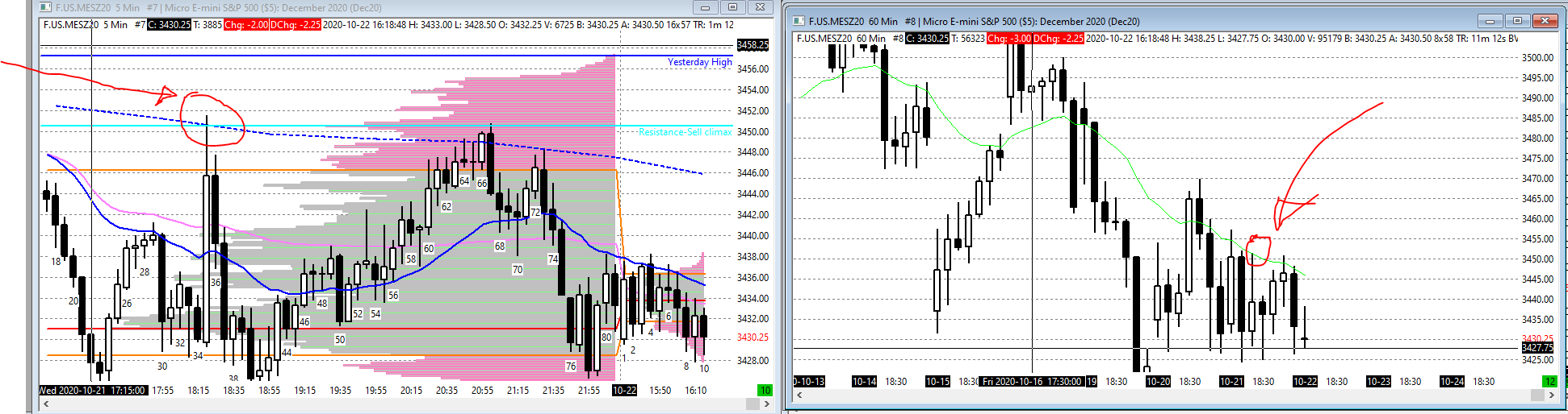

I'm trying to overlay the moving average of the 60 minutes chart into 5 minutes chart but the result is not accurate, as you can see in the attached figure.
The left chart is the 5 minutes chart with the overlayed Moving Average from the right chart (60 minutes). As you can see in the overlayed moving average is below the high of the candle whereas in the 60 minutes chart it is exactly on the top of the candle.
I've tried to change the settings but it doesn't work.
Any help please?

[2020-10-22 18:42:59]
The main issue is how you are displaying the data. You have the option for Fill Blanks with Last Value set to No. This means that the only data points that are absolutely correct are the ones that match at the same time of the opening of the bar (in other words, if there is a new bar at 18:15 in the 1 hour chart, then only the bar at 18:15 in the 15 minute chart is correct.
Otherwise, what you are seeing is a line drawn from the point at the one bar that matches to the point on the next bar that matches up (i.e. 60 minutes later). This is why you are seeing a line that has a non-zero slope to it.
Refer to the information on this here:
Study/Price Overlay Study: Fill Blanks with Last Value

[2020-10-23 13:37:35]
The Study/Price Overlay does not work in the way you have described above. It just takes the data from the other chart and overlays it onto the chart you want, directly, with no modifications to the data. Therefore, when you set Fill Blanks with Last Value to Yes, then you are seeing the data point from the 1 hour chart actually depicted on each of the 15 minute bars that make up that one hour.
To do something like what you have above you would need to use the Spreadsheet Study. Refer to the information here:
