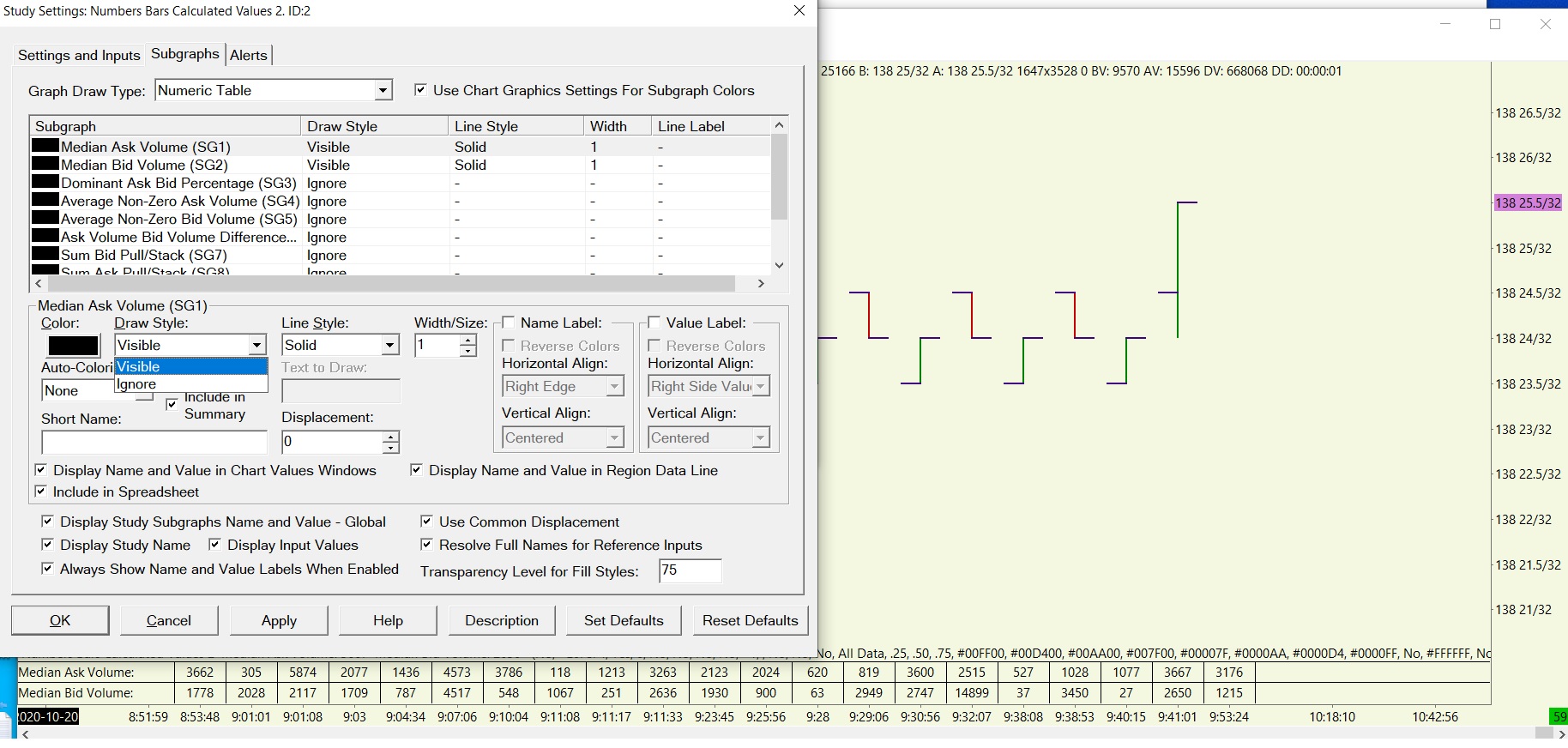

Hello I have such a question! I use the data provided by indicator the Number Bars Calculated Values 2. This data (for example, the Median Ask volume and Median Bid volume) has formed as a table data in area 2 (in the image) how Visible in Draw Style. I want the values data from table (in area 2) below to be represented as Lines (for example) in the same area 2. How do I do this?

The Numbers Bars Calculated Values 2 is always displayed as a table. There is no way to change that.
So what you need to do is use the Study Subgraph Reference and set the subgraph that you want to draw as a line, bar, etc. in the Study Subgraph to Reference Input. You can then change the draw style as wanted to draw the data as you please. Refer to the information here:
Note that you will have to put the Study Subgraph Reference in a different region from the Numbers Bars Calculated Values. Refer to the following:
Chart Studies: Settings and Inputs Tab >> Chart Region
Also, if you do not need to look at the Numbers Bars Calculated Values as a table, then you can hide that study. Refer to the information here for hiding a study:
Chart Studies: Settings and Inputs Tab >> Hide Study
