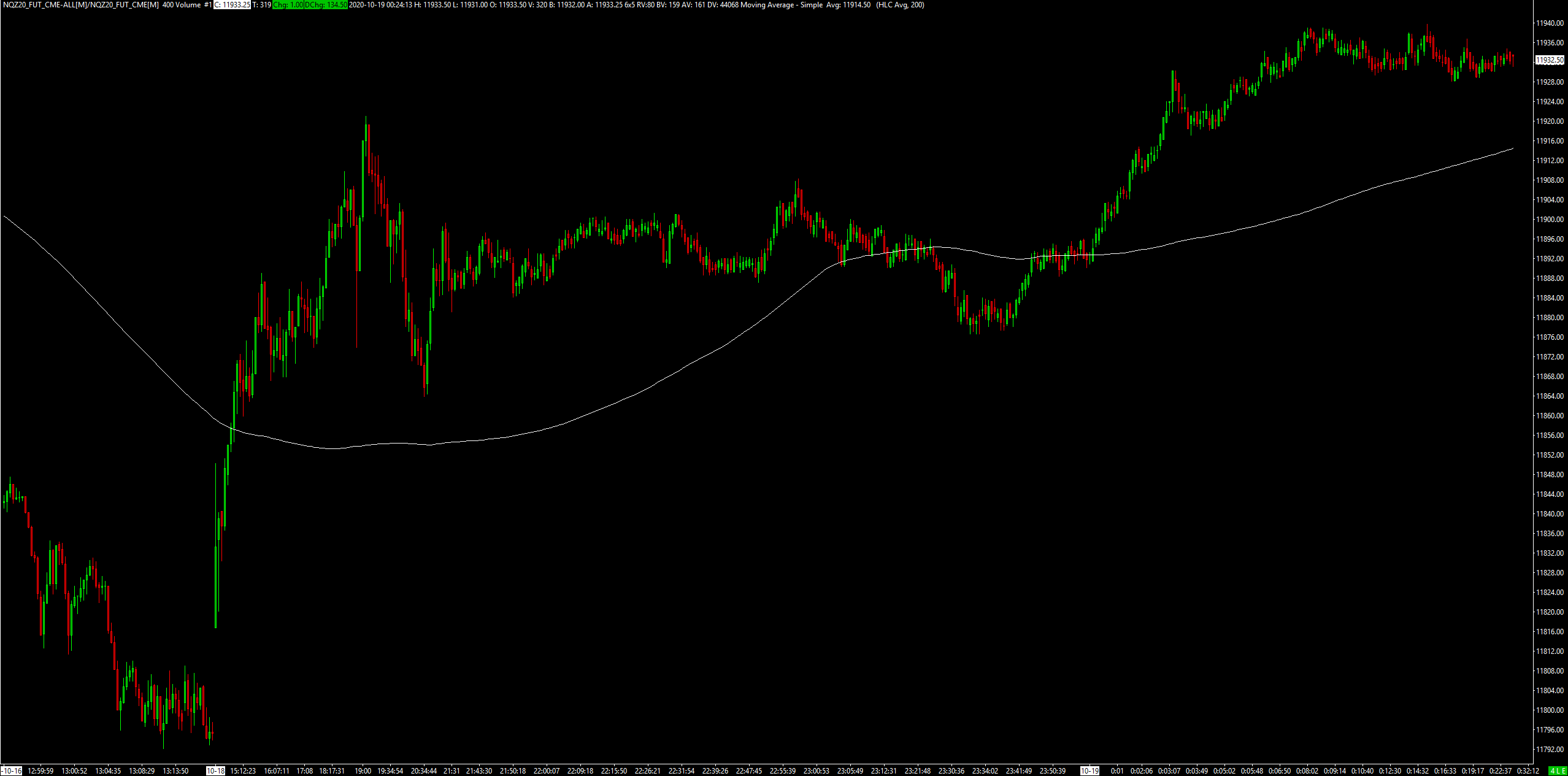

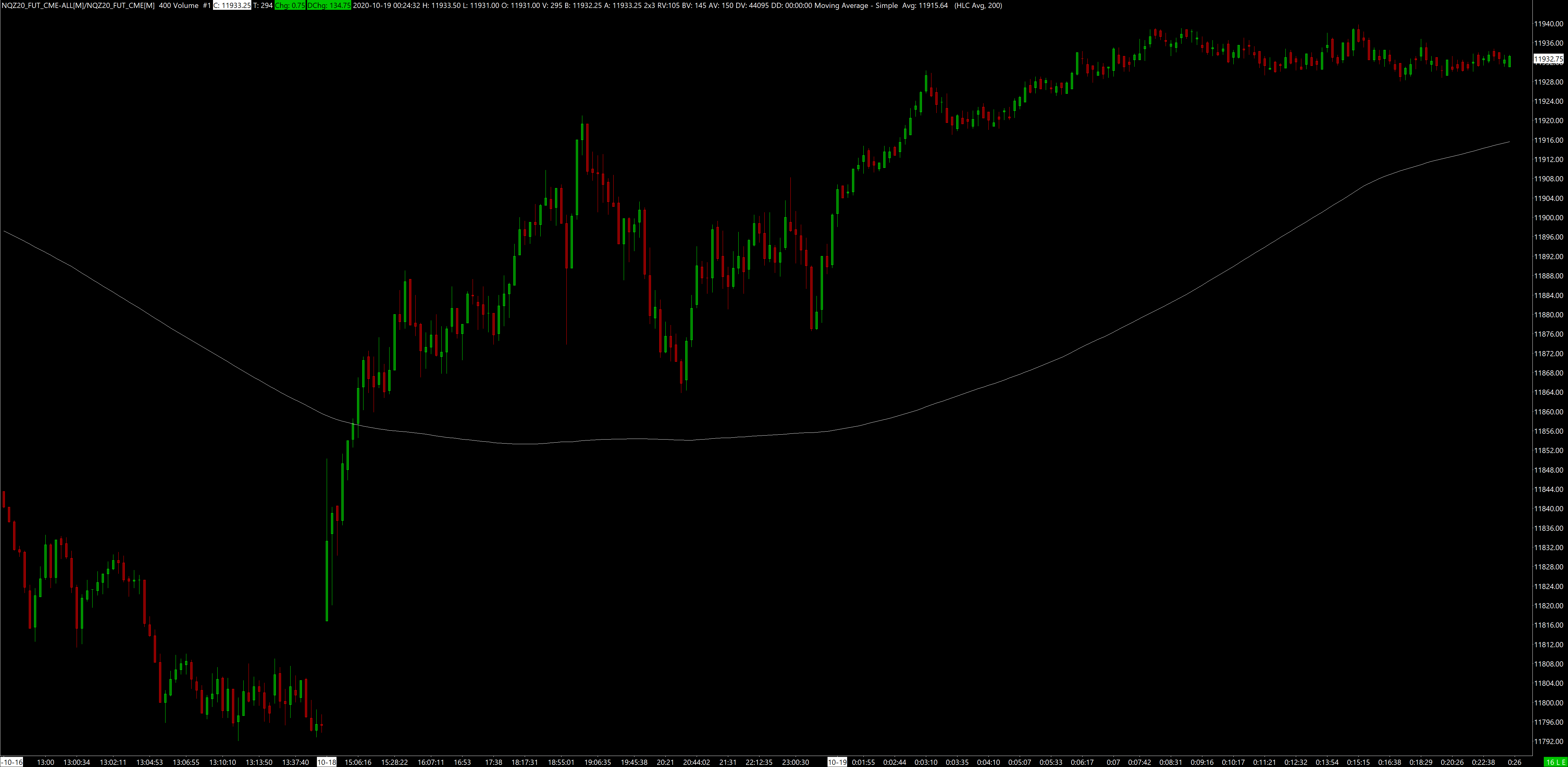

Tonight I noticed my volume charts on my local PC and Amazon EC2 differ.
Here is the EC2 screenshot: http://www.sierrachart.com/image.php?Image=1603092254696.png
Local PC: http://www.sierrachart.com/image.php?Image=1603092274147.png
As you can see even the 200 simple moving averages are different.
My chart settings:
- Volume Per Bar
- Setting: 400
- Symbol: NQZ20_FUT_CME-ALL
I am using SC Futures Order Routing/Data [trading]:
- Primary Server: Server 2
- Backup Server 1: Server 1
- Backup Server 2: Server 5
- Intraday Data Storage Limit Unit: 1 Tick
Is it normal to have different volume bars on different machines? I have also noticed the countdown do not match. I am having this issue with volume bars, time based bars like 5 minutes is ok.
I would appreciate helping me out.
Thank you
[2020-10-19 15:44:34]
Definitely do not use this symbol suffix:
NQZ20_FUT_CME-ALL
That is absolutely going to cause data variations which we will not help with at all.
Also refer to:
Working With Charts: Resolving Differences of Chart Bars Between Charts
Date Time Of Last Edit: 2020-10-19 15:44:50
[2020-10-19 19:39:36]
User617678 - Posts: 8
Thank you very much. Removing the suffix fix my issue.
