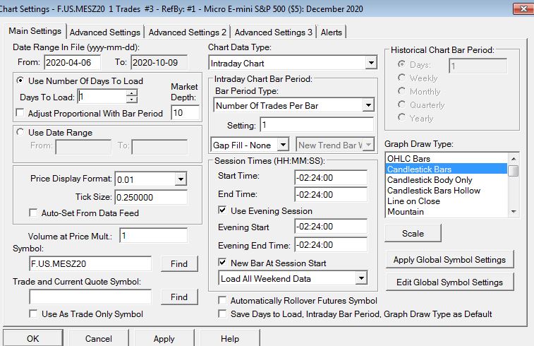

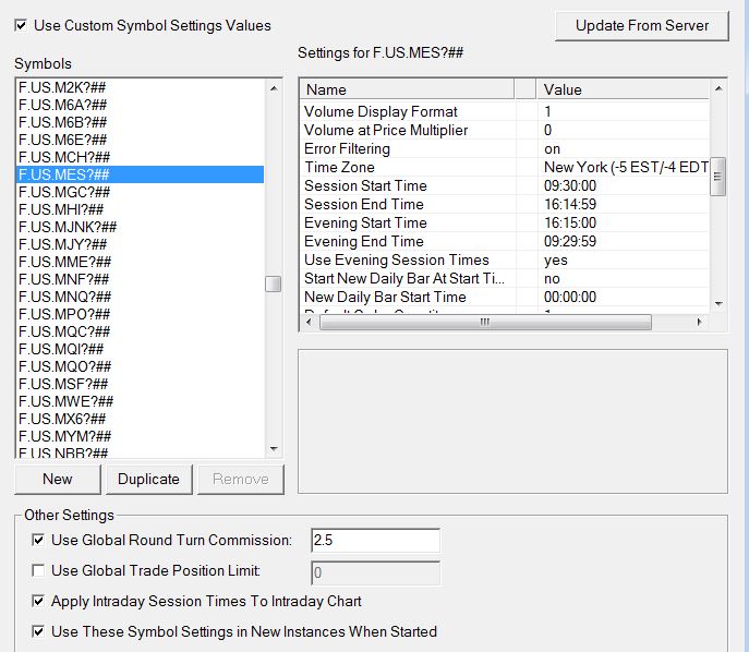

I recently upgraded from SC version 2158 to version 2177. One of my custom studies opens a 1-tick chart and this was working perfectly in version 2158, but now the tick chart is blank and I found that the session times on the chart are set at -02:24:00 for start and end times (see attachment TickChartSetting). The settings for session times in Global Settings >> Symbol Settings are correct (see attachment SymbolSettings).
It's impossible to manually change the session settings on the tick chart as it immediately reverts to thge invalid times.

imageTickChartSettings.JPG / V - Attached On 2020-10-09 19:41:29 UTC - Size: 97.72 KB - 413 views
imageSymbolSettings.JPG / V - Attached On 2020-10-09 19:41:46 UTC - Size: 83.41 KB - 363 views

Your documentation for sc.OpenChartOrGetChartReference states the following with regard to Session Times:
"SessionStartTime, SessionEndTime: These specify the primary Session Start and End times. These session times are optional and only apply to Intraday charts. If the session times are not specified, then the Intraday Session Times from Global Symbol Settings are used."
My custom study does not set session times when it opens the tick chart, therefore the session times should, according to your documentation, be taken from the Global Symbol settings, which have the correct values as shown in the file I attached. The Global Symbol session times are inserted correctly in SC version 2158, but not in version 2177.
