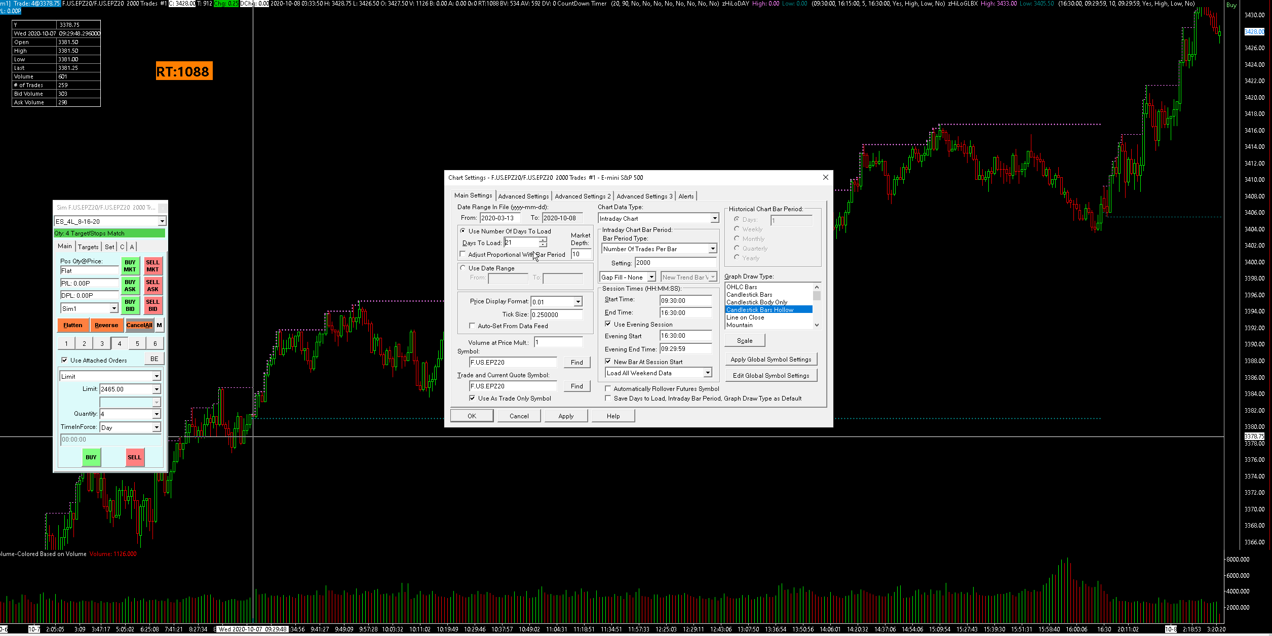

Hello Support,
Just found that your built-in study [High Low for the time period - extended] has wrong start time ob version 2177 when using TICK CHARTS
V2150 on my spare [backup] laptop looks OK
Could you fix it, please?
Note - chart book with the single chart - according to your instructions + screenshot [to see where to look - just to save you some time] attached.
Thanks in advance.
imageSC=HiLo_4_timePer_ext=wrong_start_on_the_TICK_chart.png / V - Attached On 2020-10-08 07:47:59 UTC - Size: 117.42 KB - 455 views
attachmentHiLo_4_time_period_ext=wring_at0930.Cht - Attached On 2020-10-08 07:49:41 UTC - Size: 9.14 KB - 446 views

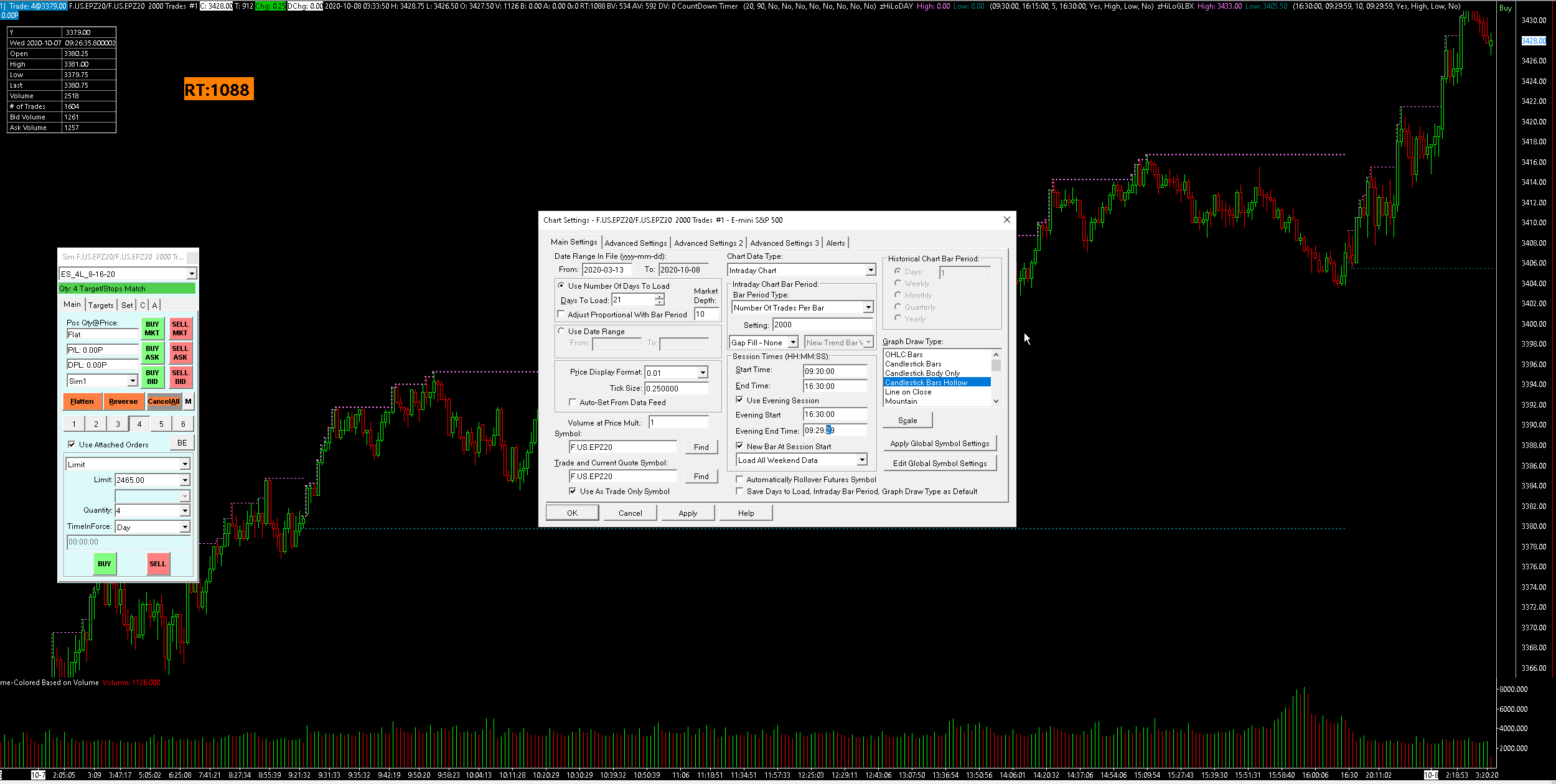

Start time for the day session should be 09:30, not 09:26.
I've just attached picture from v 2150 showing correct graph [starts at 09:30]
imageHiLo_v2150=correctStartTime=0930=NOT_0926_on_v_2177.png / V - Attached On 2020-10-08 10:09:31 UTC - Size: 76.3 KB - 473 views

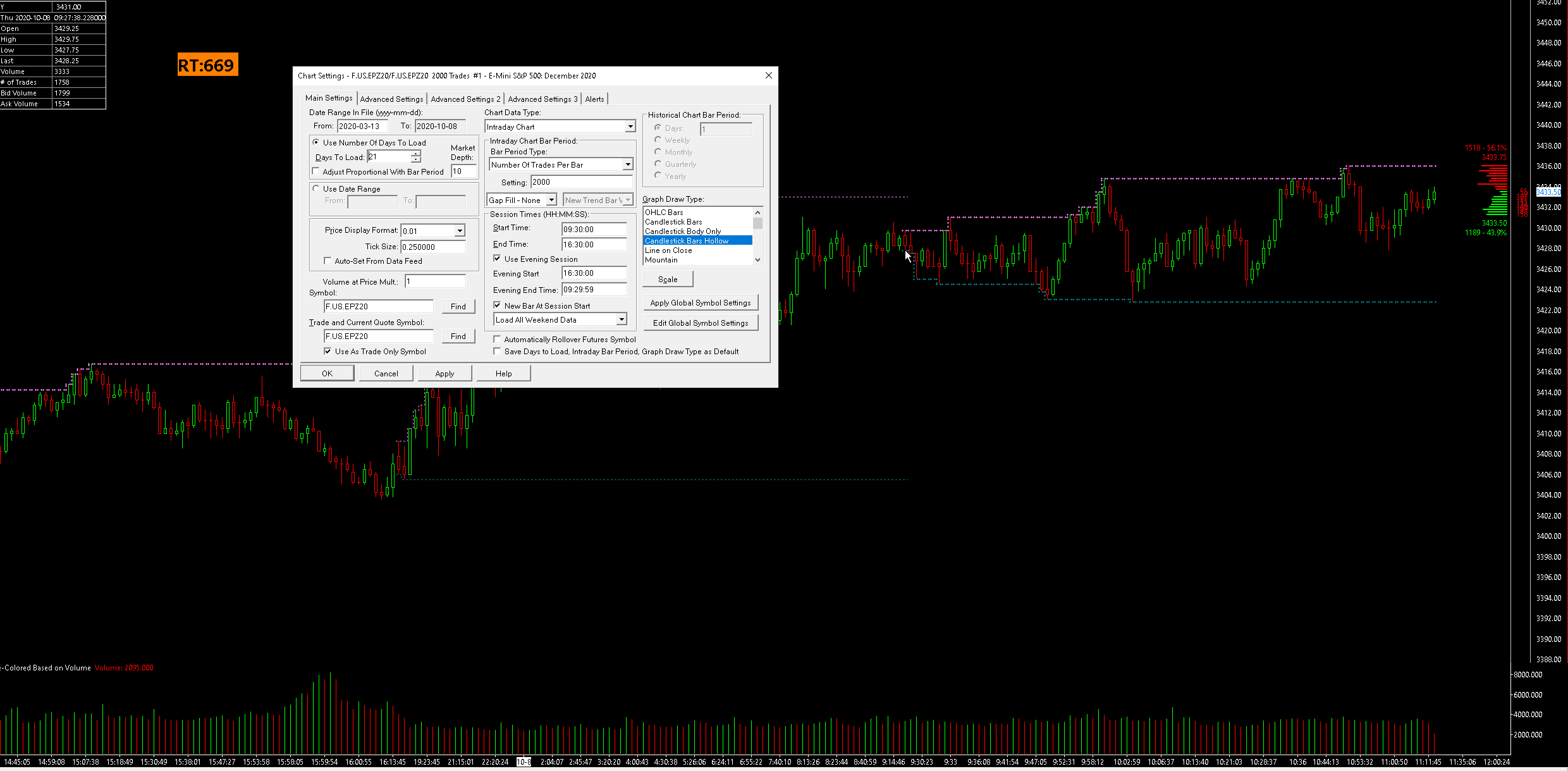

Just curious. Could either of you post pictures of your Session Times settings from the Chart Settings box?
[2020-10-08 12:55:51]
User112177 - Posts: 8
Hello User212764,
Yep, just did, thanks for helping us out : )).
Old session ENDiNG time was 09:29:29, typo obvously - that's why I couldn't figure why "High-Low" for the day started at 09:26
When I've changed it to 09:30:00 or 09:29:59 - start time "Hi-Low Daily" bar "moved" from 09:26:51 to 09:29:48 [was 09:30:00 exactly on v 2150]
NOTE: 1-minute & 5-minute charts do NOT have this problem; daily graph starts at 09:30 [as expected] - doesn't matter 09:29:29 or 09:29:59 or 09:30:00
imagesc_settings_Session_times_OLD=092929.png / V - Attached On 2020-10-08 12:55:16 UTC - Size: 155.18 KB - 486 views
imagesc_settings_Session_times=092959.png / V - Attached On 2020-10-08 12:55:24 UTC - Size: 159.73 KB - 466 views

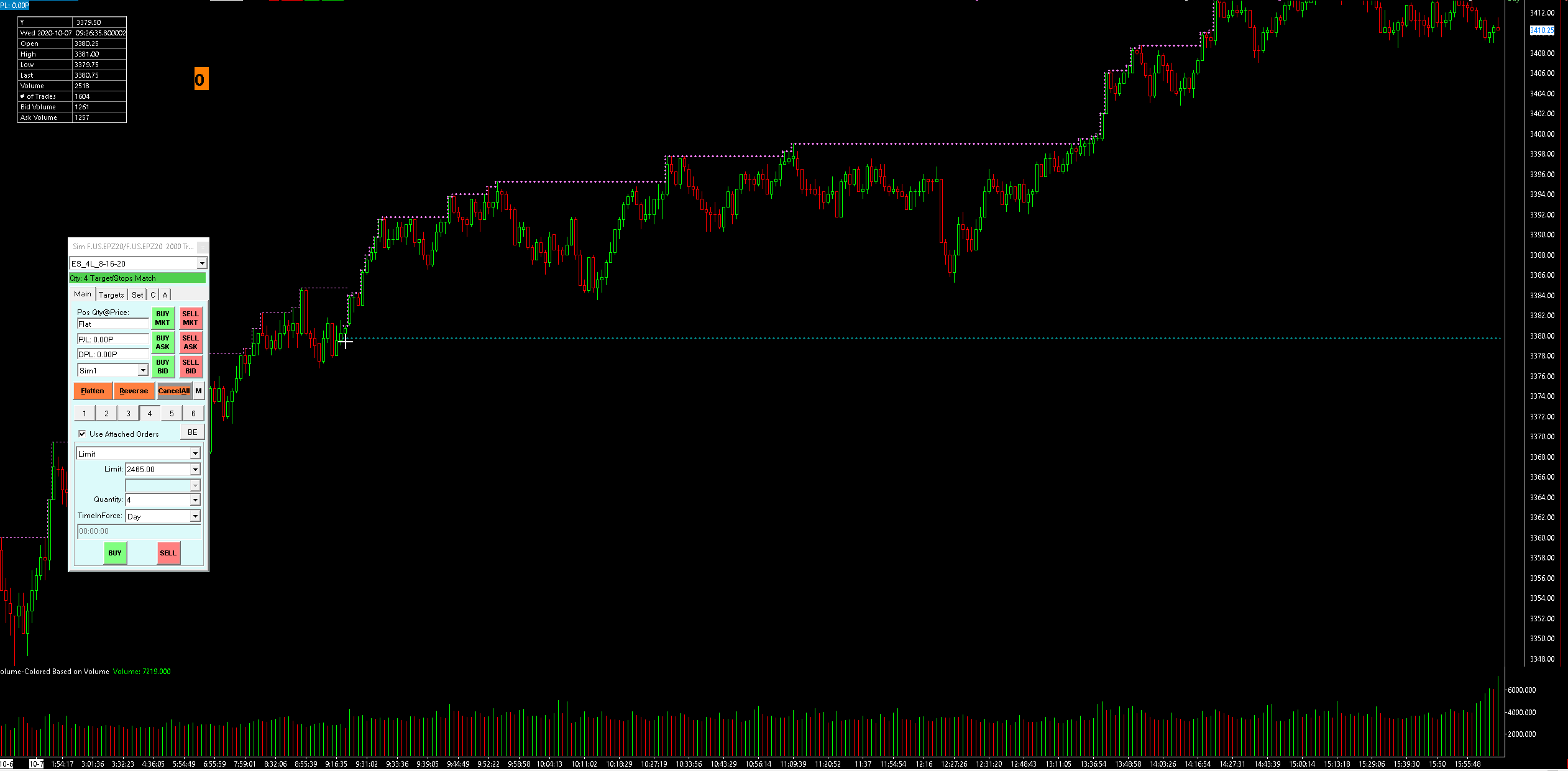

[2020-10-08 15:37:22]
User300921 - Posts: 7
PS just checked setting & everything else [reloaded data etc]: today DAY session "started" at 09:27:38
imageSessTime=Doesnt_matter=Same_today=starts_at_092738.png / V - Attached On 2020-10-08 15:37:13 UTC - Size: 119.68 KB - 410 views
