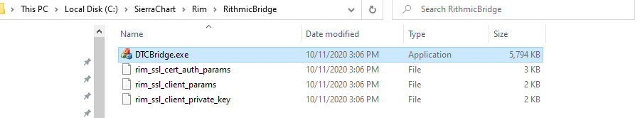

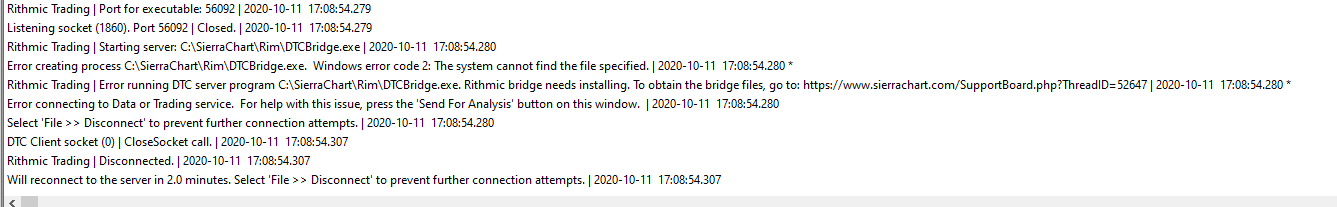

Does this look correct? I downloaded the files and then extracted them. I'm shit with computers, so trying to figure this out. I know you guys don't want to deal with Rithmic issues, but it'd help me out a lot. As stated previously, I'd be more than happy to just payu a fee for you guys to remote in and get the files corrected for me. I attached pictures of the files in the rim folder, as well as the error I'm getting from sierra chart when I try connecting.

[2020-10-12 13:48:11]
Copy all the files in the directory that you currently have them (they are currently in C:\SierraChart\Rim\RithmicBridge) then go up one level and paste them there (the directory you need to paste them into is C:\SierraChart\Rim).
[2020-10-12 15:26:12]
User423419 - Posts: 16
That worked, thank you
