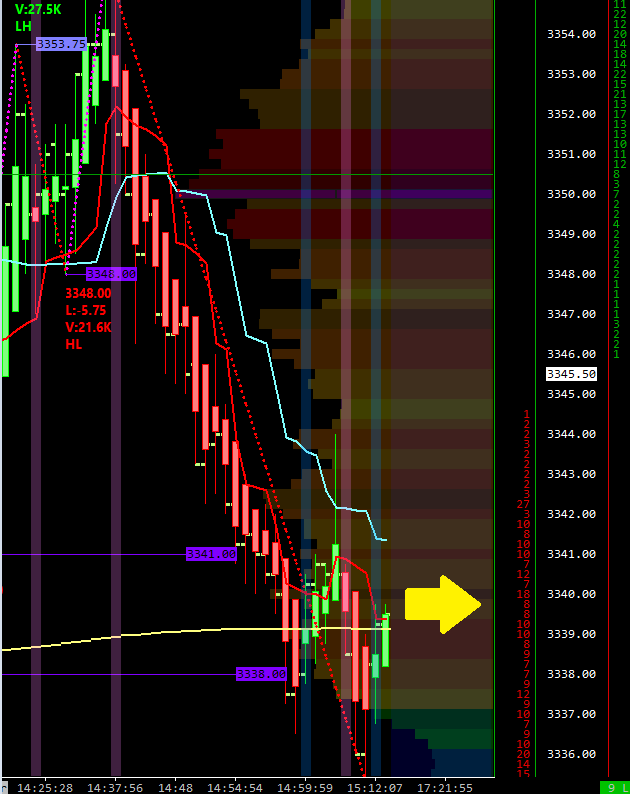

Does anyone know how to fill the space between the last bar and right window? It is currently occupying a lot of real estate. Please see graphic attached. Thanks.
imageCapture.PNG / V - Attached On 2020-10-03 08:07:40 UTC - Size: 65.06 KB - 467 views

You can disable 'Lock Fill Space' or reduce amount of space used.
Working With Charts: Scrolling The Chart and Right Side Fill Space
Working With Charts: Locking the Right Side Fill Space
[2020-10-05 06:48:41]
Yes the links given above are what you need to refer to.
