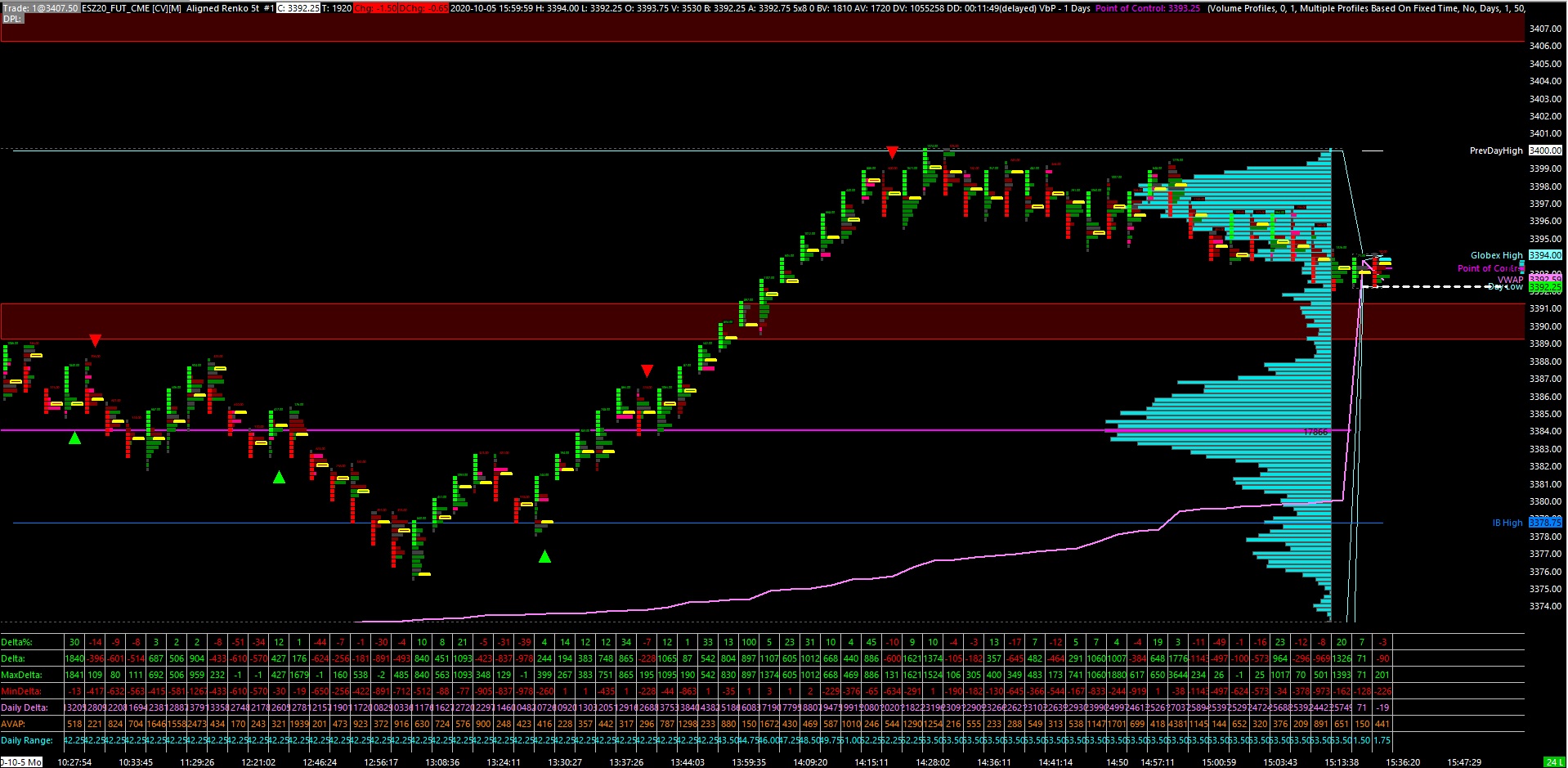

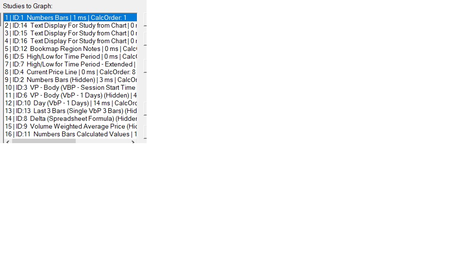

Im so sorry for asking this but I am not the best when navigating around sierra.... Where Do i find the information for the CPP file so i can add it to the list for custom studies? I have 6 custom charts that im trying to share that i have in one chart book and they are super complex with adjusted settings in each chart. Here is a few examples attached.. Perhaps due to my lack of coding abilities these should be custom studies by now and im not sure how to exactly make it that. I know this is the worst answer i can give considering most of you guys in here are well versed especially in sierra/code, so please bear with me and I apologize. I was only allowed to do 3 attachments on this MSG so i included 2 of the charts that work together but only got a chance to do a clip of the settings for the 1st indicator. but you can see they are very complex is what i was trying to show.

Based on your study settings, it does not appear that you are using a custom study, so there is no cpp file. Without a custom study, you cannot control who is authorized to run it. You can allow only certain people to download the chartbook, but you will not prevent them from sharing it with others, nor lock other users out.
A developer could combine most of the elements of your studies into a custom study, however, some of them, like the numbers bars study cannot be coded into a custom study as the source code is not provided for them by Sierra. The best you can do is use a password on the studies and hide your settings. The password is not needed to use the study, only to hide it.
