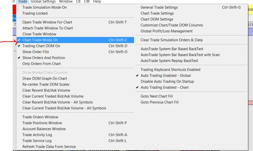

Hello Support,
- I would like to unsubscribe CME and subscribe to EUREX market instead.
Is it possible to do it?
- Is Sierra Symbol name different from CQG datafeed cause I can't find the 10 years US T NOTE.
Can you provide me the symbol for this?
- and The CBOT seems doesn't appears on my chart.
imagetrade on mode.JPG / V - Attached On 2020-09-28 15:12:20 UTC - Size: 68.89 KB - 380 views
imageDOM.JPG / V - Attached On 2020-09-28 15:12:48 UTC - Size: 93.62 KB - 312 views

First, you are not getting the data from the CME through us (Sierra Chart). You are currently getting your data from CQG. You would need to talk to your Broker about changing the data feed. Or, if you want, you can stop the CQG data feed and then use the Sierra Chart Exchange Data Feed for the EUREX. Refer to the information here:
Symbol names are different depending on what Data/Trading Service you have selected. It looks like you have selected the correct symbol for the 10 Year US Treasury Note for CQG. If you are not getting data for this, then you would need to speak to your broker to ensure that you are setup to receive that data from CQG.
