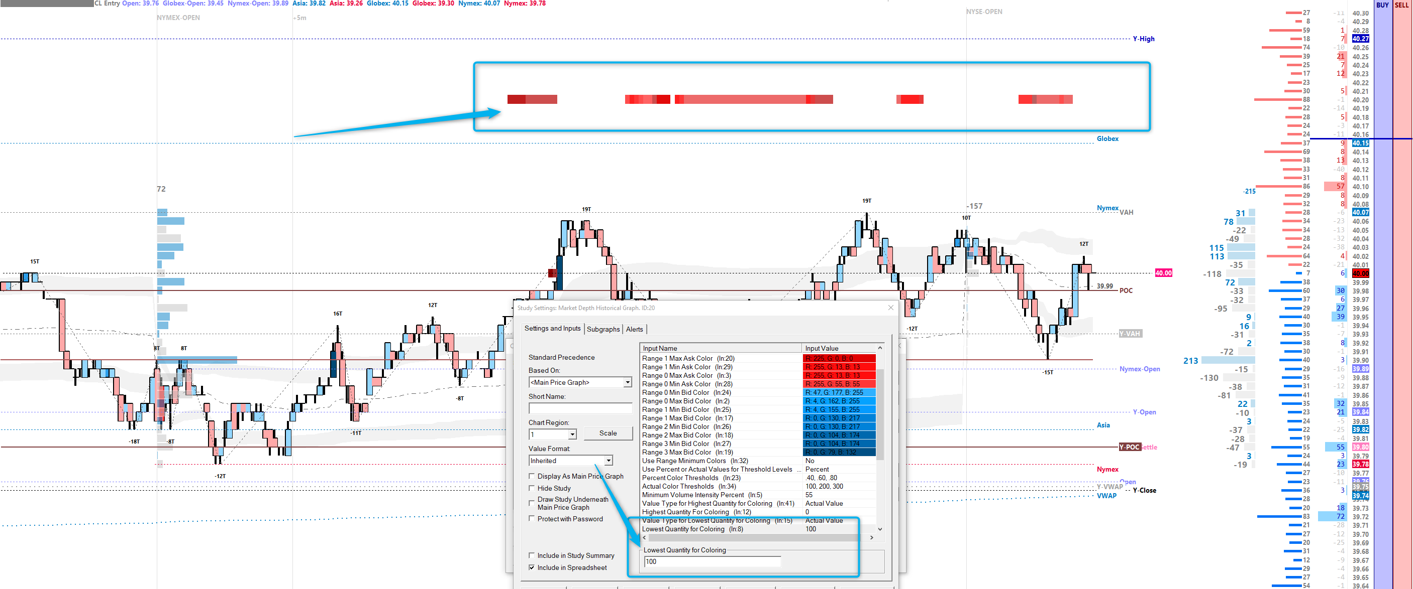

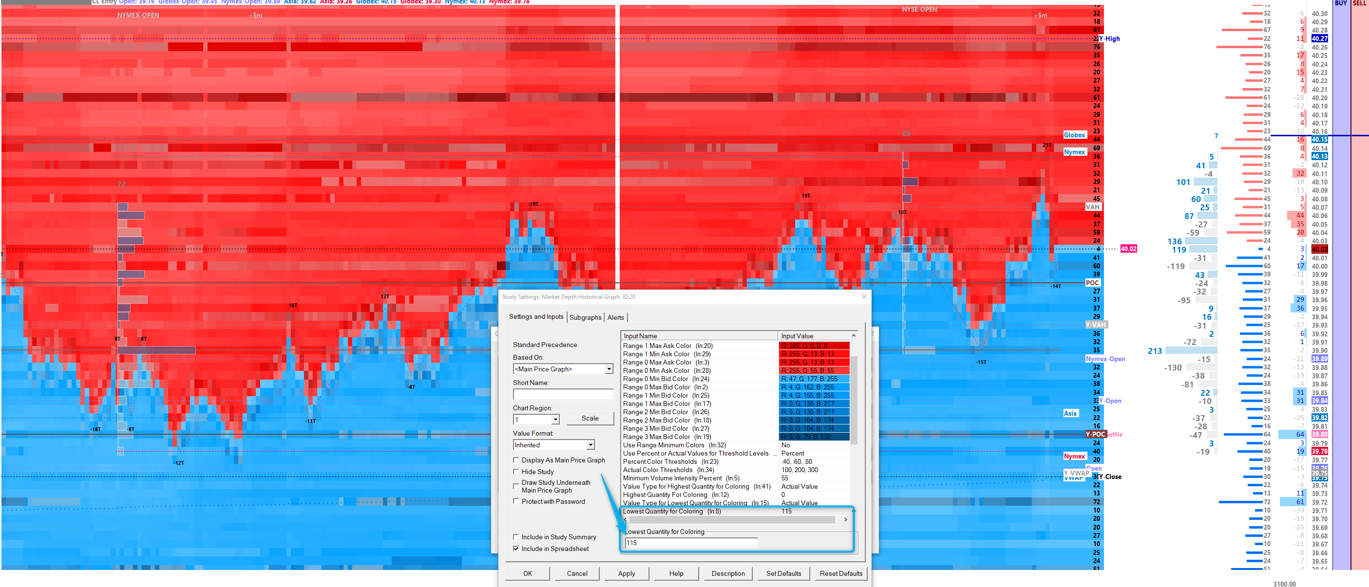

If in the Market Depth Historical Graph Study at CL_F the "Lowest Quantity for Coloring" is above 110 shows all levels, if it is lower, works fine.
image2020-09-23_15h36_24.png / V - Attached On 2020-09-23 13:42:36 UTC - Size: 446.6 KB - 418 views
image2020-09-23_15h35_01.png / V - Attached On 2020-09-23 13:42:52 UTC - Size: 230.56 KB - 346 views
[2020-09-23 14:09:10]
We will get this fixed.
The reason it is occurring is because the value of 115 is more than the Maximum Quantity in the area that you are looking, and it is not updating properly. If you lower the value to be 1 (or more) less than the actual Maximum, then it will be correct.
