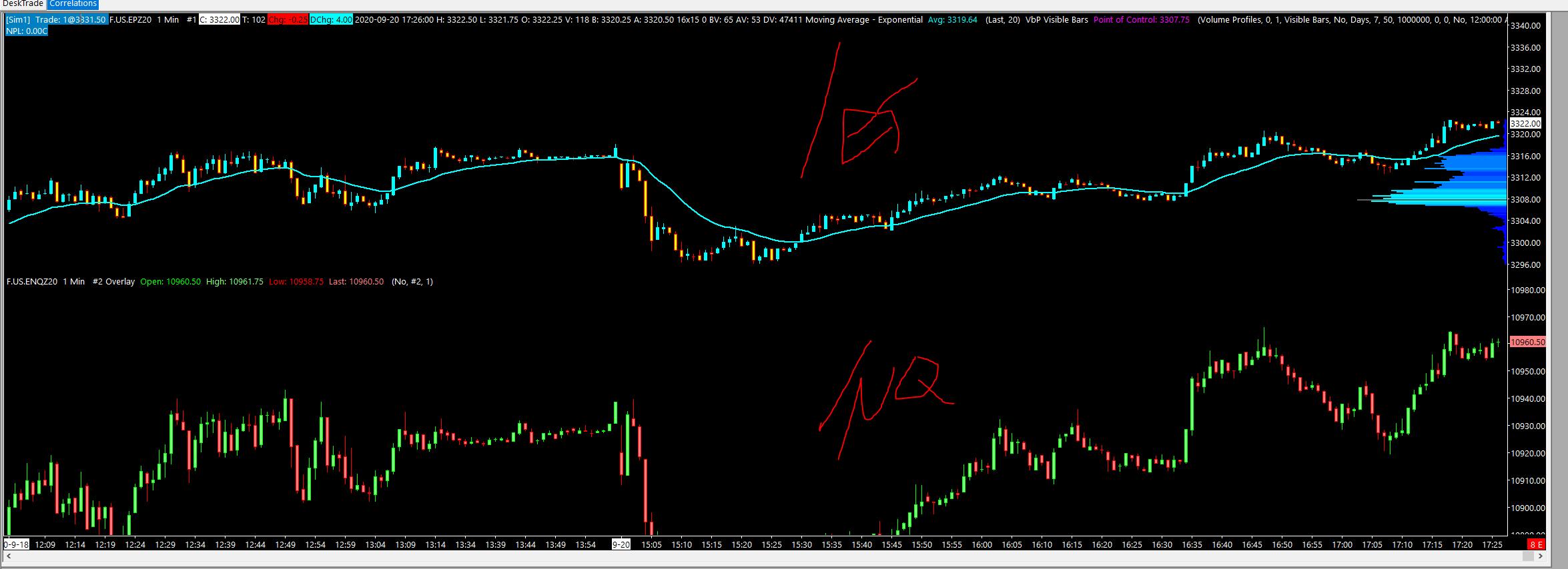

Hello, below ill post an image of an /es chart with /nq overlaid via overlay (bar) study. Is it possible to put a study on the overlayed /nq chart like a VBP for example, and how would i go about doing that?

You really should use the Add Additional Symbol study to put the NQ on the chart, then most studies will work with the Add Additional Symbol. But, the Volume by Price and TPO are a few that will not work. Refer to the following for the Add Additional Symbol study:
Note the section in there entitled Basing Other Studies on Add Additional Symbol.
