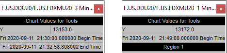

I noticed that my M3 chart shows begin and end time, but the M1 Chart only shows begin time (see pic).
What is the reason for this?
Many thanks

[2020-09-14 11:16:27]
It is because the chart is not maintaining the array for the ending date-times. Add this study to the chart:
Bar End Time

[2020-09-14 12:01:39]
nicktrader - Posts: 813
I'm afraid you didn't understand me properly (my fault).
Only my M3 Chart shows the End Time, all other charts in the Chartbook do not show it.
Even if I remove all studies in this M3, the End Time is shown.
I am just wondering how this can happen.

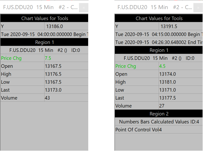

[2020-09-15 02:37:41]
I think I have found the " bug".
The left picture shows the "naked" M15 chart.
Then I added the study "NB Calc...Values" and the right picture shows the End Time. If I remove the Study, the End Time is still displayed.

[2020-09-15 12:27:34]
This is not a bug. If you want to remove the end time display, just reload the chart with Chart >> Reload and Recalculate.
