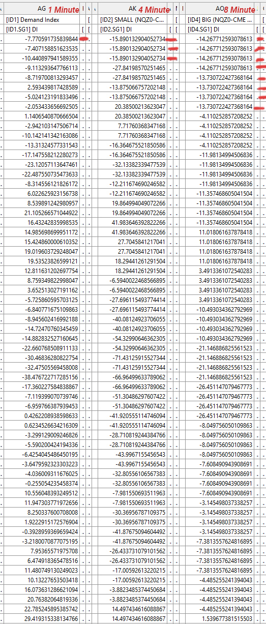

I basically made a spreadsheet trading system with 3 time frames. A 2 minute, 4 minute and 8 minute time frame. I the same indicator on all of them. With a Study/Price overlay I put them all in one place, which is perfectly fine. But the main problem is is that the 4 and the 8 minute time frame update at a different rate (which makes sense). What I want to do is to have the values of the 4 minute and 8 minute, but on a 2 minute basis.

The 8 minute timeframe changes the values for the 10:00 - 10:06 time because that candle is still going. What I would like is to have the value that it has when it closes on 10:02, to stay fixed and not change anymore. Is there any way of doing that?

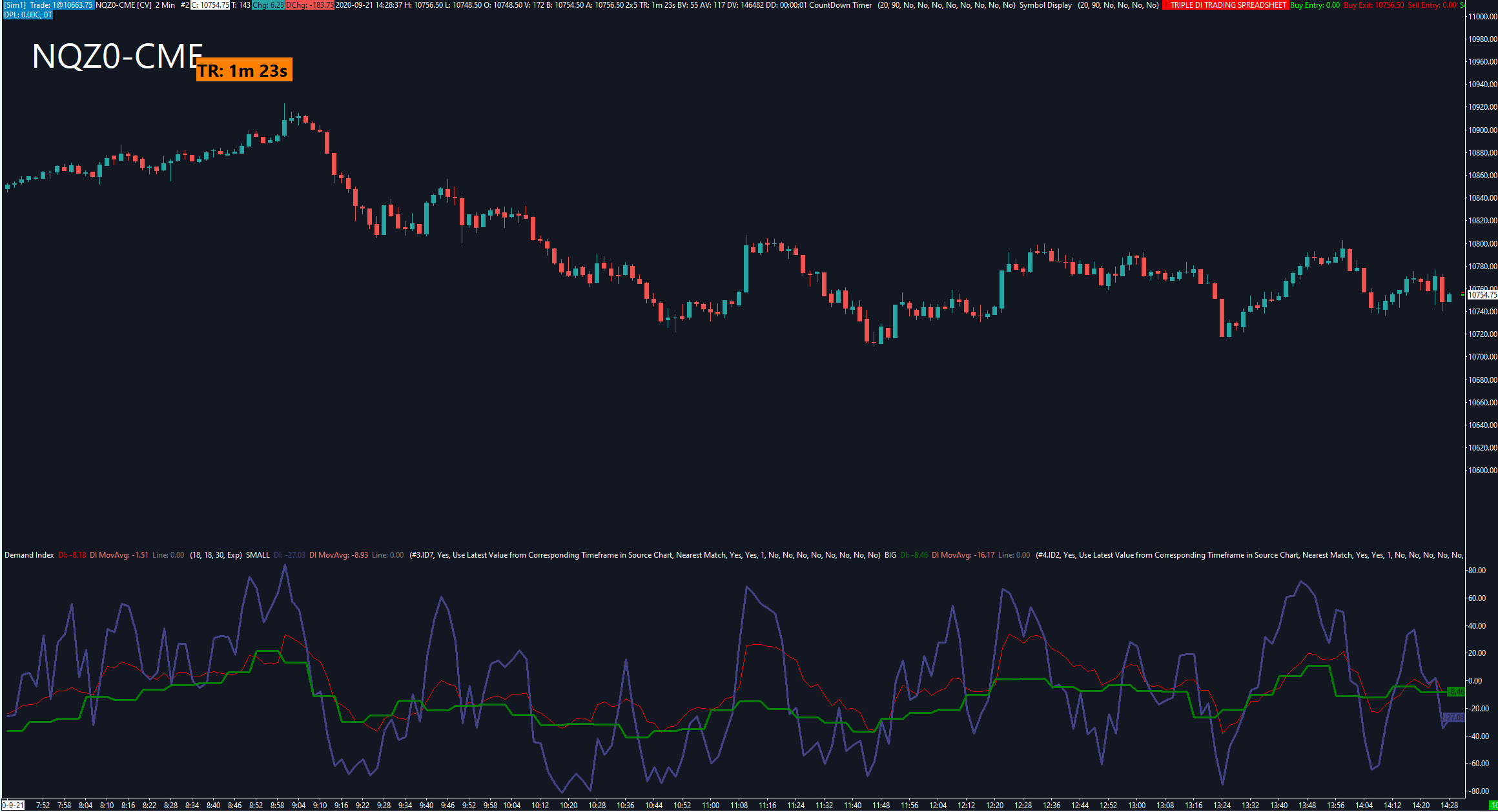

So I'll explain again since I don't think you understand what point I am trying to make. I have a spreadsheet trading system that uses the Study/Price overlay to overlay my indicator from my 8 minute chart on the 2 minute chart. This means that that indicator has a 8 minute interval in the spreadsheet. All values during that 8 minute will change because that candle is still going. What I want to have it that every time a 2 minute candle is closed, it takes the value of the 8 minute candle as well so that that doesn't change anymore. Because if it does, it changes the data in the past as well on recalculate, which messes up with backtests because the lines are already calculated and show fake results.

imageChart.jpg / V - Attached On 2020-09-21 12:40:46 UTC - Size: 838.69 KB - 445 views
imagespreadsheet jpg.jpg / V - Attached On 2020-09-21 12:42:35 UTC - Size: 1.02 MB - 456 views
