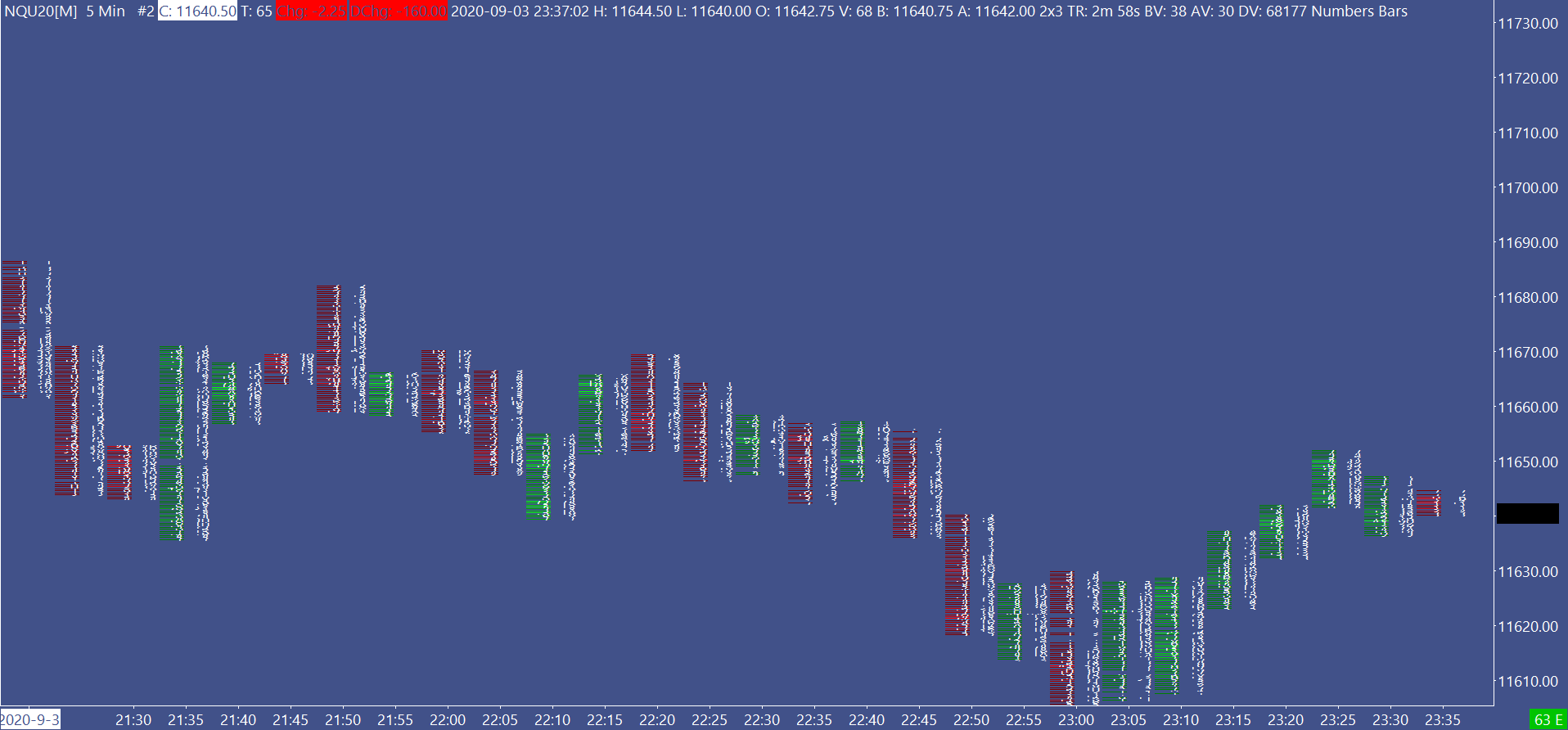

Hello, I am currently playing around with Sierra Chart and number bars... trying to change the text font size inside the number bars which are too small... I cannot find the place to change it.
Attached is an example what it looks like now.
Thanks,
http://www.sierrachart.com/image.php?Image=1599191236799.png

still having same issue...the issue it just occurs when I use the NQ instrument.. for CL and ES it shows visible size for bid and ask under the number bars...can someone assist me with this..thanks.

Which font method are you using for the NQ chart - Same as Chart Font, or Automatic with Minimum/Maximum?

I don't see the option Automatic with Minimum/Maximum Limits under the Font tab.

There is an Input for the Numbers Bars study that is called Font Size Mode. It is in there that you have the two options.
It sounds like this Input is set to Same as Chart Font and that that chart has it's own font settings instead of using the Global Settings. If you use the Automatic setting you should have better results and more control over the font for just the Numbers Bars. Again, refer to the information here:
