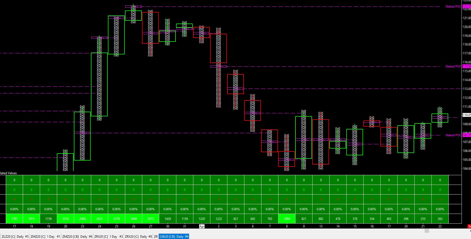

wallstreetsson - Posts: 80
Thanks for your quick replay. Maybe you could help with this issue.
I want to see Delta values of an expired or older contract. For Example OJK20. Unfortunately it only shows me the volume.
As attachmend you will find a screenshot showing the issue.
Best Regards
Luigi
imageUnbenannt.JPG / V - Attached On 2020-09-01 17:04:33 UTC - Size: 215.13 KB - 383 views
[2020-09-01 17:41:50]
John - SC Support - Posts: 48408
That is a Daily chart and the Numbers Bars study does not work with Daily data. Refer to the information in the Introduction section here:
Numbers Bars: Introduction

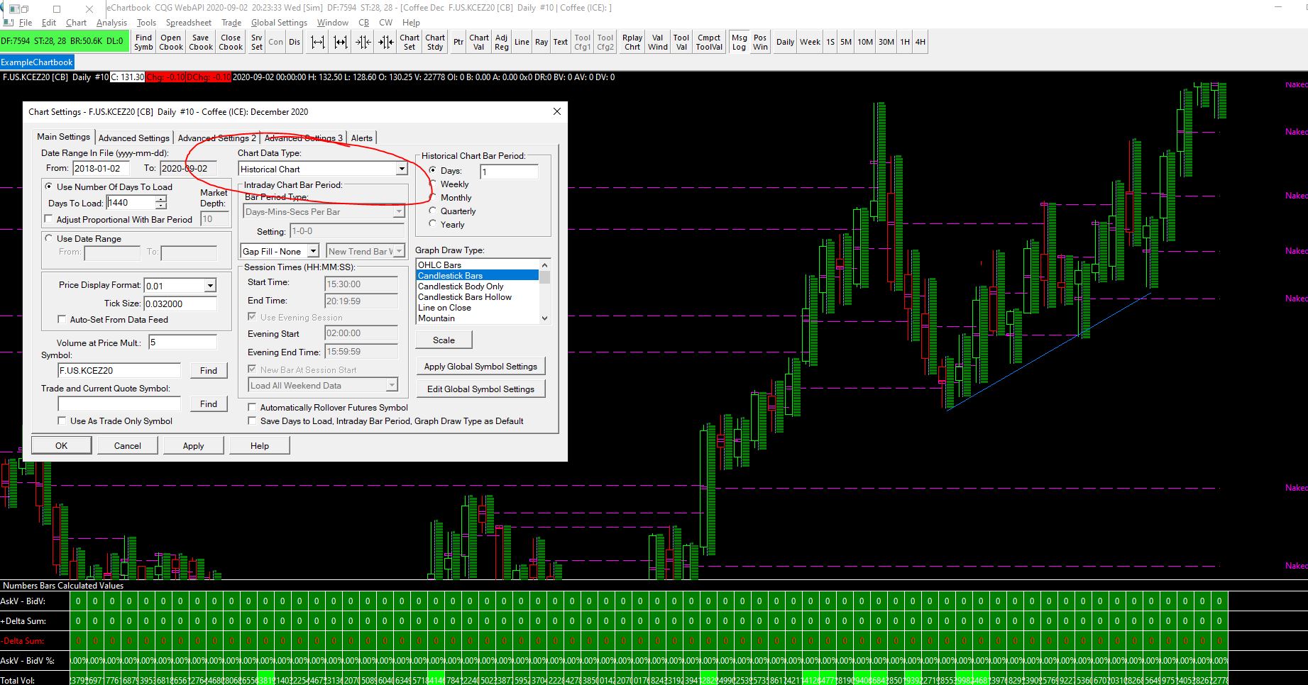

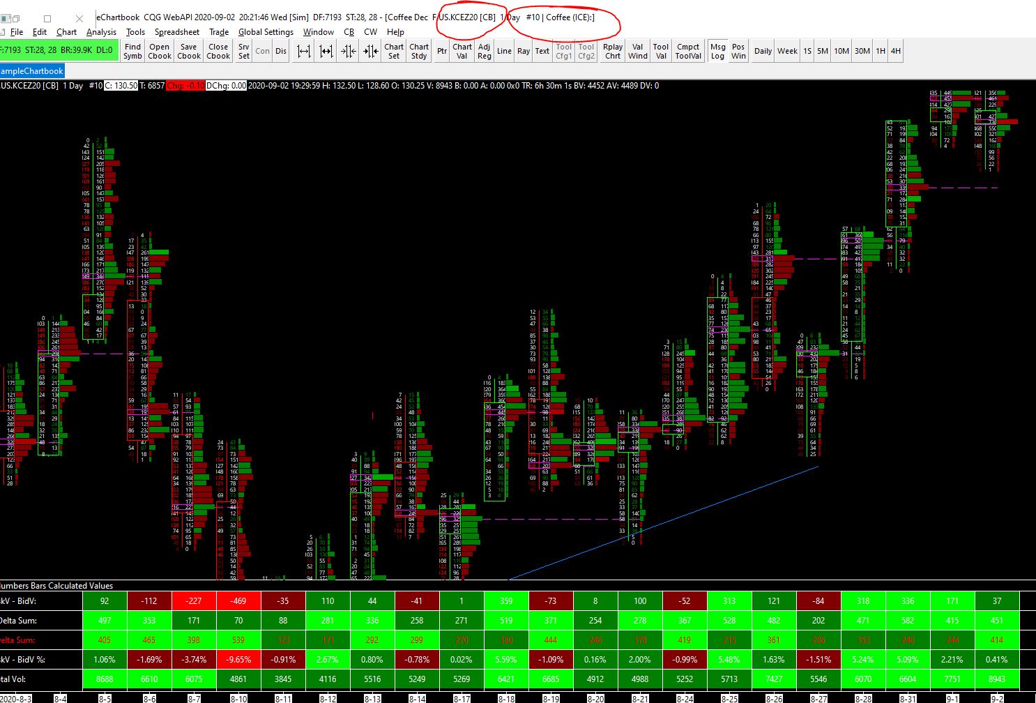

[2020-09-02 18:24:36]
Do you mean daily or historical data? Looking at the chart in the attached screenshot, it seems like it is daily data but only for current contract. Continious is not possible..
So there is no way to backtest Orderflow with numberbars?
image1.JPG / V - Attached On 2020-09-02 18:24:07 UTC - Size: 235.12 KB - 425 views
image2.JPG / V - Attached On 2020-09-02 18:24:11 UTC - Size: 320.81 KB - 355 views
[2020-09-02 19:04:23]
You are correct, specifically, the Numbers Bars study does not work with Historical Daily data. The reason is that the historical daily data does not include the bid and ask prices, only the OHLC data is stored along with total volume.
Therefore, if you want to look at Numbers Bars on a Daily chart, you would need to set Chart >> Chart Settings >> Main Settings >> Chart Data Type to Intraday Chart Only. Then, if you change to a Daily timeframe, it will still be using the intraday data. Refer to the information here:
Chart Settings: Chart Data Type (Chart >> Chart Settings >> Data Limiting >> Date Range and Limiting Method)
