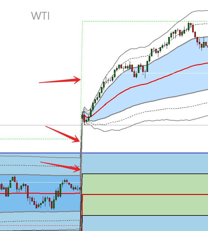

With my ECI vwap or VWAP or IBR studies, when say the session start time is 14:090 gmt, the IBR study draws a connecting line from the former session end time to the new session start time. It makes the charts a bit mucky. I was wondering if this is a global setting issue? I have tried fixing this with several types of dra style. Image attached.
I have seen on other peoples charts they do not have this issue with he IBR study.
attachmentsc issue.jpeg - Attached On 2020-08-26 12:11:32 UTC - Size: 51.5 KB - 365 views

Try the Draw Style of Dash. Refer to the following:
Chart Studies: Dash (ACSIL: DRAWSTYLE_DASH)

cool. will try that one. Thanks. Any chance the VWAP part of the issue could be delt with in an update? I know its a tiny thing...
[2020-08-26 15:39:53]
John - SC Support - Posts: 48480
The Volume Weighted Average Price study is set to have a Draw Style of Dash by default. If this is not what you are seeing, then check to make sure that you have not created a custom study default for it. Refer to the information here:
Chart Studies: Using Custom Default Study Settings
[2020-08-27 07:03:13]
Refer to:
Chart Studies: Avoiding Vertical Joining Line for Study Subgraphs
