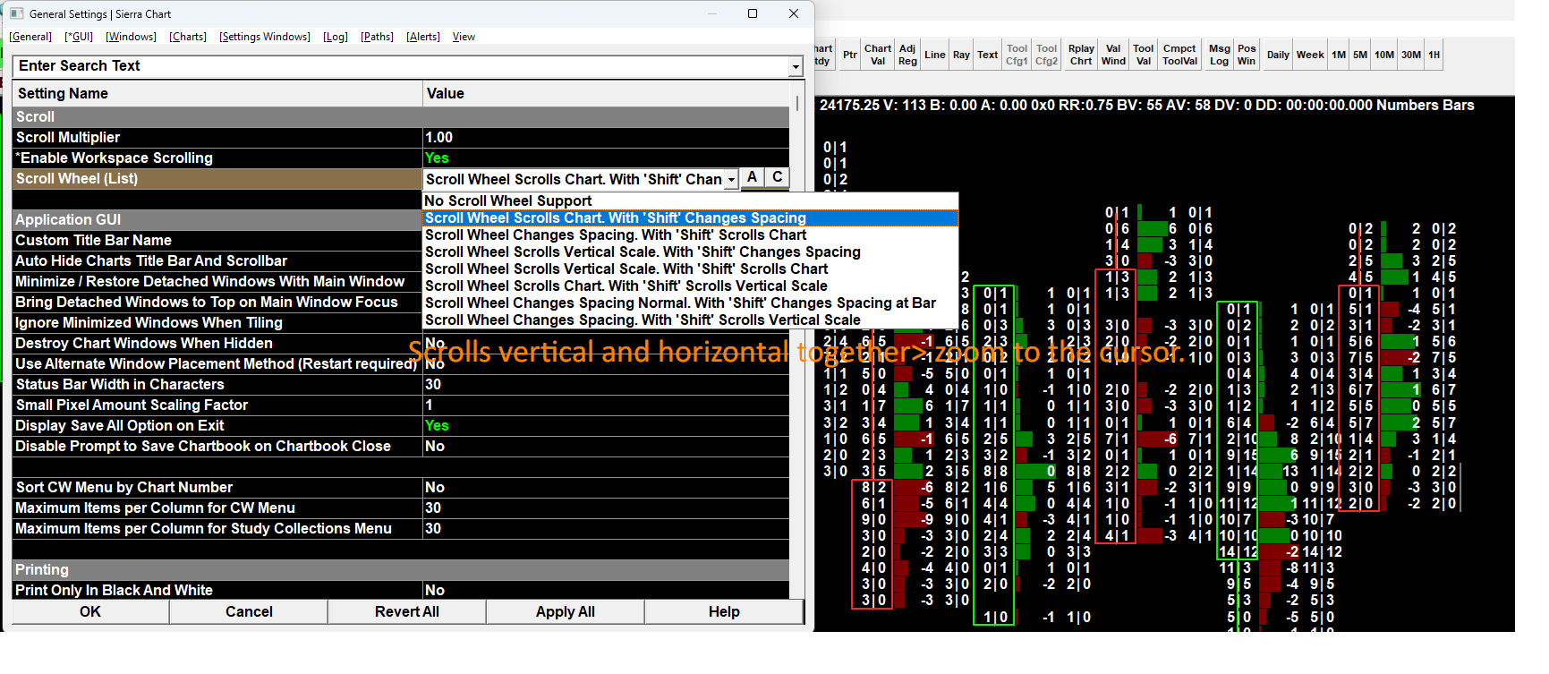

Lowry BigEarth - Posts: 51
:-DDD found where to enable hand tool vertical movement... Learning every hour... :-DD
Found the GUI for mouse wheel settings > missing the same time horiz and vertical expanding and shrinking by scrolling.
Thank you.
