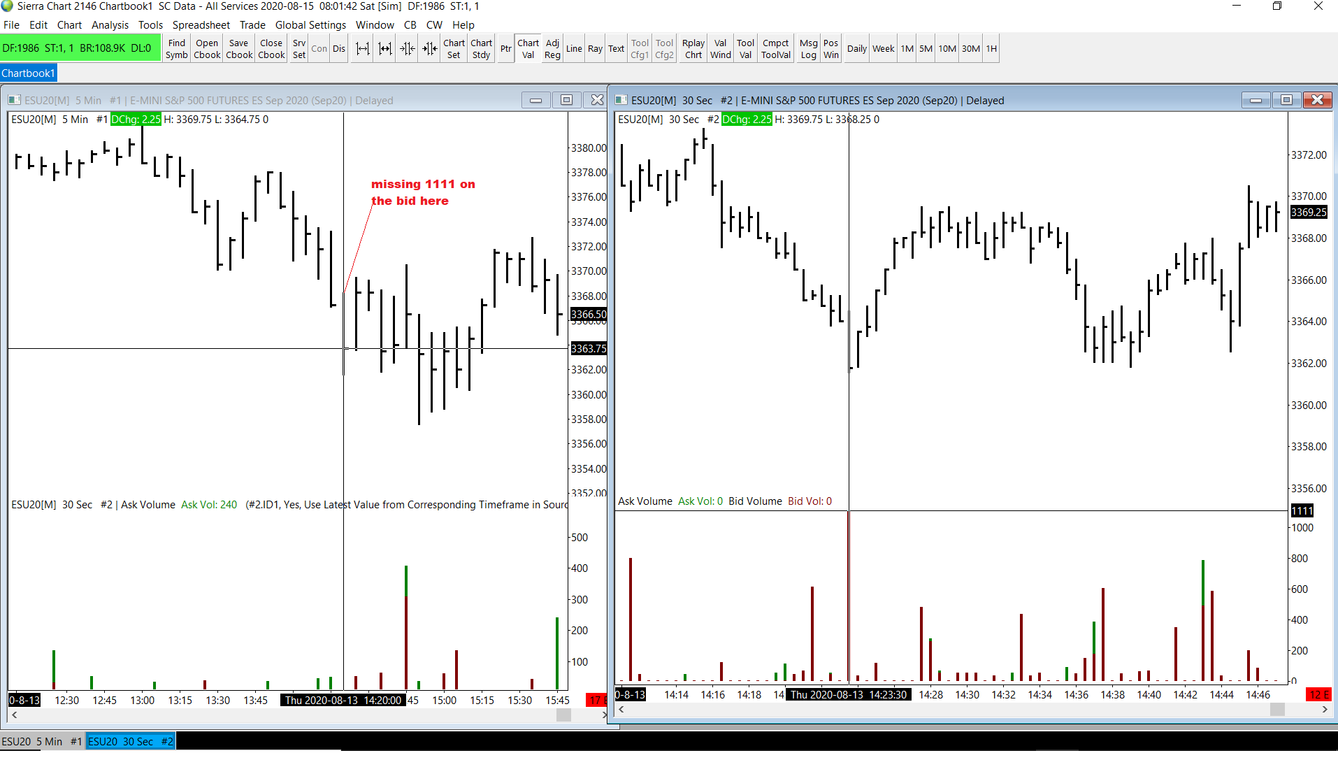

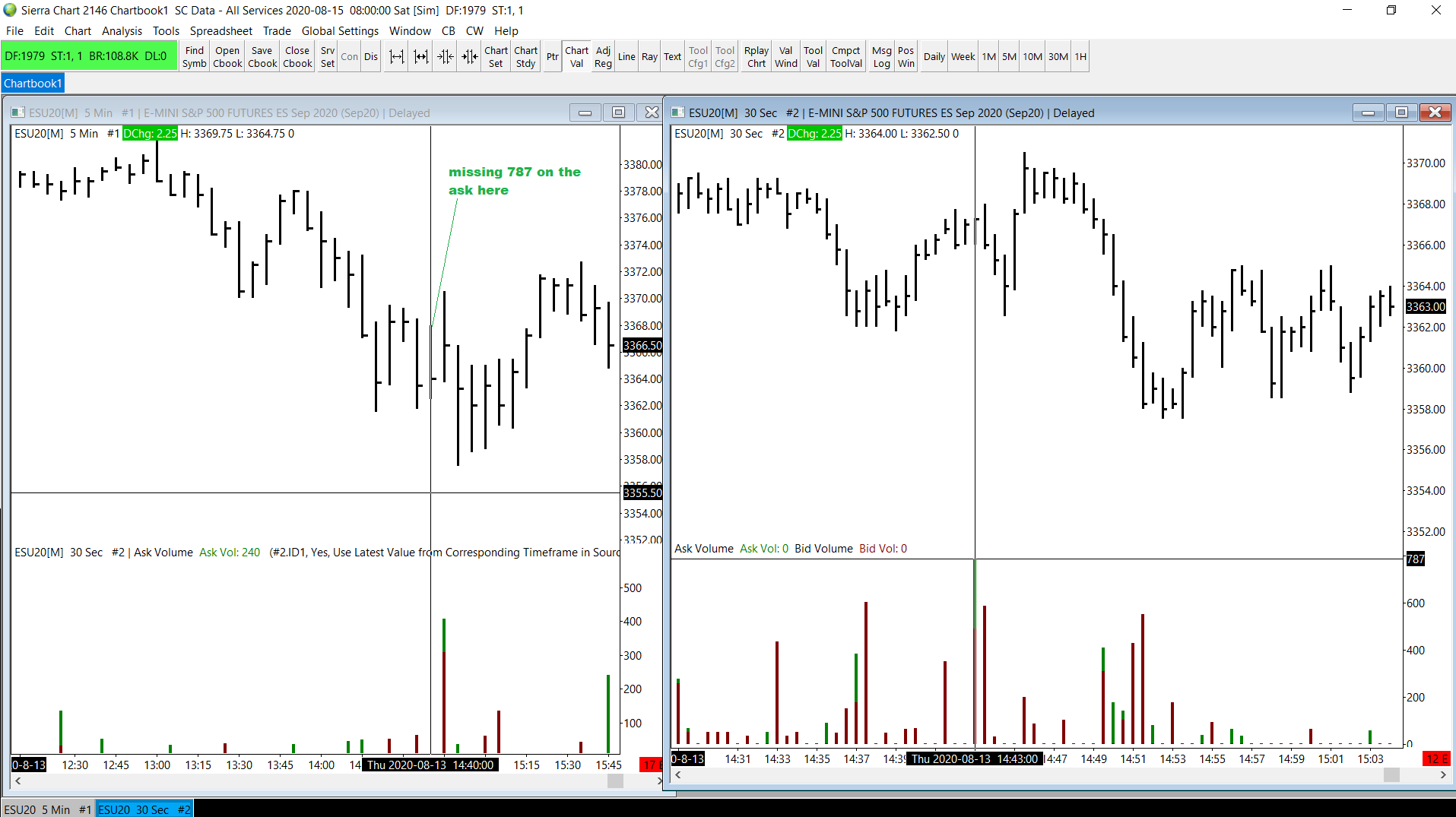

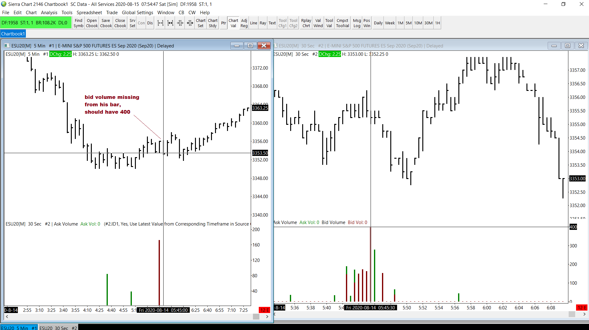

Hi there, I noticed a bug in this study. The volumes are either in the incorrect bar, or missing.
I have two charts on the chartbook = 5min and 30sec. 30s is configured to filter volume equal or less then 29. Bid vol and ask vol loaded on the chart.
In 5min I loaded study/price overlay study, chose the bid and ask vol studies from 30s chart, chose the option for bar match to "containing match" (but really, does not make any difference this option , already checked), but as you can see from the screenshots, there is a lot of missing volume in the 5min chart that happened inside that bar in 30s. I also attached to this post the chartbook file, so you can check for yourself.

[2020-08-15 12:42:23]
User907968 - Posts: 885
It might be worth re-reading the documentation for the study/price overlay study (Study/Price Overlay Study: Study/Price Overlay Study), particularly this part - Study/Price Overlay Study: Data Copy Mode

In the example "A" that I posted, the value that happened at 15:59:30 can´t possibly be contained inside the 15:55:00 bar.

[2020-08-15 13:15:33]
This was the specific information that explains why you see 'missing volume', if the earliest (or latest) 30s bar is empty, then the 5min will also show empty.
You can choose to copy the data from the earliest bar/column in the corresponding timeframe in the source chart onto the destination chart. Or, you can copy the data from the latest bar/column in the corresponding timeframe in the source chart onto the destination chart.
15:55:00 = 15:55:00 -> 15:59:59
