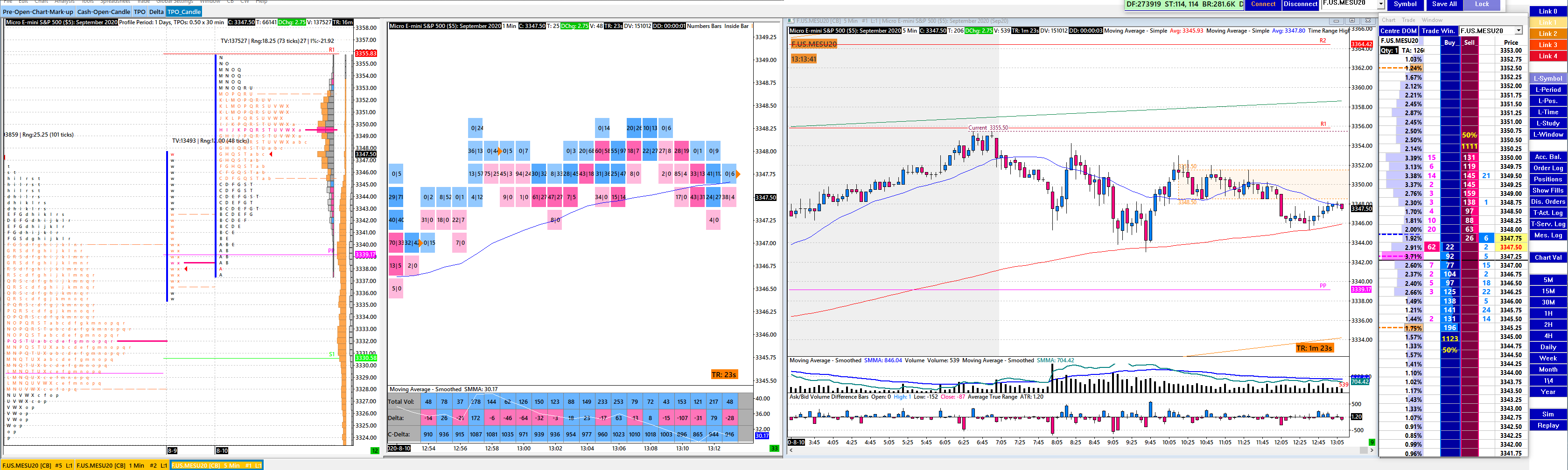

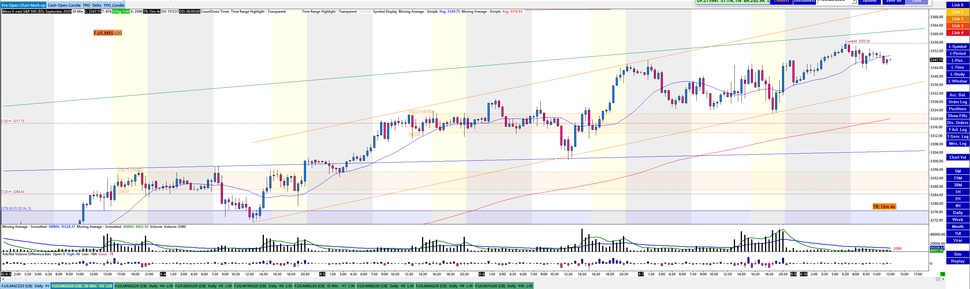

I use one Chart Book "Pre-Open-Chart-Mark-up" to mark up my charts (Capture_1.PNG)
I then copy those drawing over to another chart via Chart Book "TPO_Candle" (Capture.PNG) via Chart Settings, "Copy Chart Drawings".
In the second Chart Book, I have several different charts which are all linked via "Link 1" and "Symbol". When I change the Symbol, the Copied Chart Drawings do not change with the symbol.
How can I work around this?

This is not clear for us, and those chart images are not helpful and are overly complex.

What is not clear? The images do not need to be clear to explain the issue.
One Chartbook is used for markup.
A second chartbook has 3 charts in it and a Dom. They are all linked via the same symbol.
The second Chartbook has a candle stick chart in it and I need to copy the drawings from the first chart book charts over too the second Chartbook candle stick chart.
The problem is when I change symbols on the second chartboook, the drawings from the first Chartbook should update in the candle stick chart on the second Chartbook depending on which symbol is selected.
