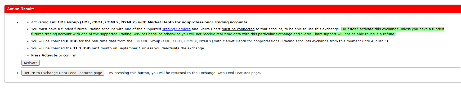

HeyUgly - Posts: 290
ok ive found that setting in DTS, now when i subscribe to Denali
im still getting this error when selecting the 31.25 option to activate
i know IB isnt a supported broker and i get it, do i just activate anyways? sorry for a dumb question i figured this wouldnt be confusing

[2020-08-01 12:14:21]
You can proceed with the exchange activation. What you want is supported but you do need to connect once a month to your trading account. Refer to:

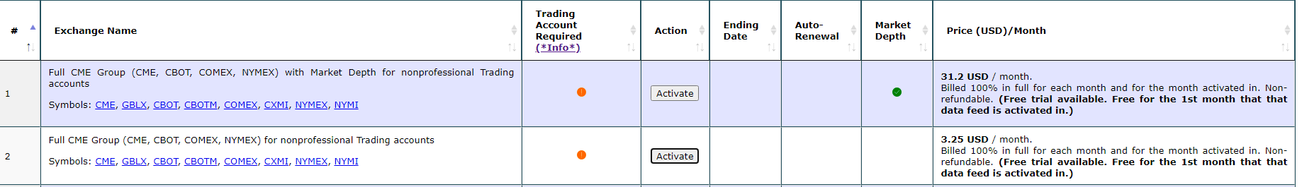

and to be clear, im choosing the no1 option on here to activate the exchanges
but i get that warning, is it ok to proceed? i know im not using IB to connect at this time as im moving to ironbeam.cannon this week
but need data.
imageyo.PNG / V - Attached On 2020-08-01 12:14:13 UTC - Size: 35.36 KB - 452 views

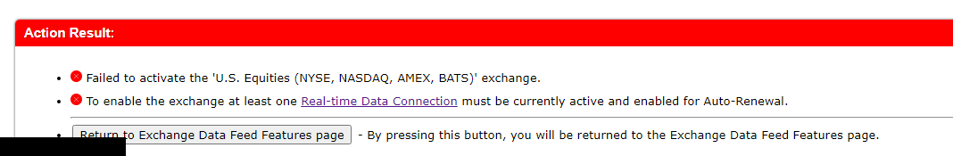

im just trying to add US equities now, futures is working and account says its setup for auto renew, but i get this erroe
pic attached. again, checked account and said its set for auto renewal
thank you again fro the help
imageyo.PNG / V - Attached On 2020-08-01 15:20:46 UTC - Size: 12.7 KB - 376 views
[2020-08-02 03:14:28]
User550780 - Posts: 8
Denali is for Futures. To get US Equities (and other market feeds), you need to subscribe via the (old) SC Real Time Exchange Data Feed. See https://www.sierrachart.com/UserControlPanel.php?page=ExchangeDataFeedFeatures
Once you've done with all the subscriptions, just select SC - All Data in your DTS Setting to receive both futures and equities market feeds.
