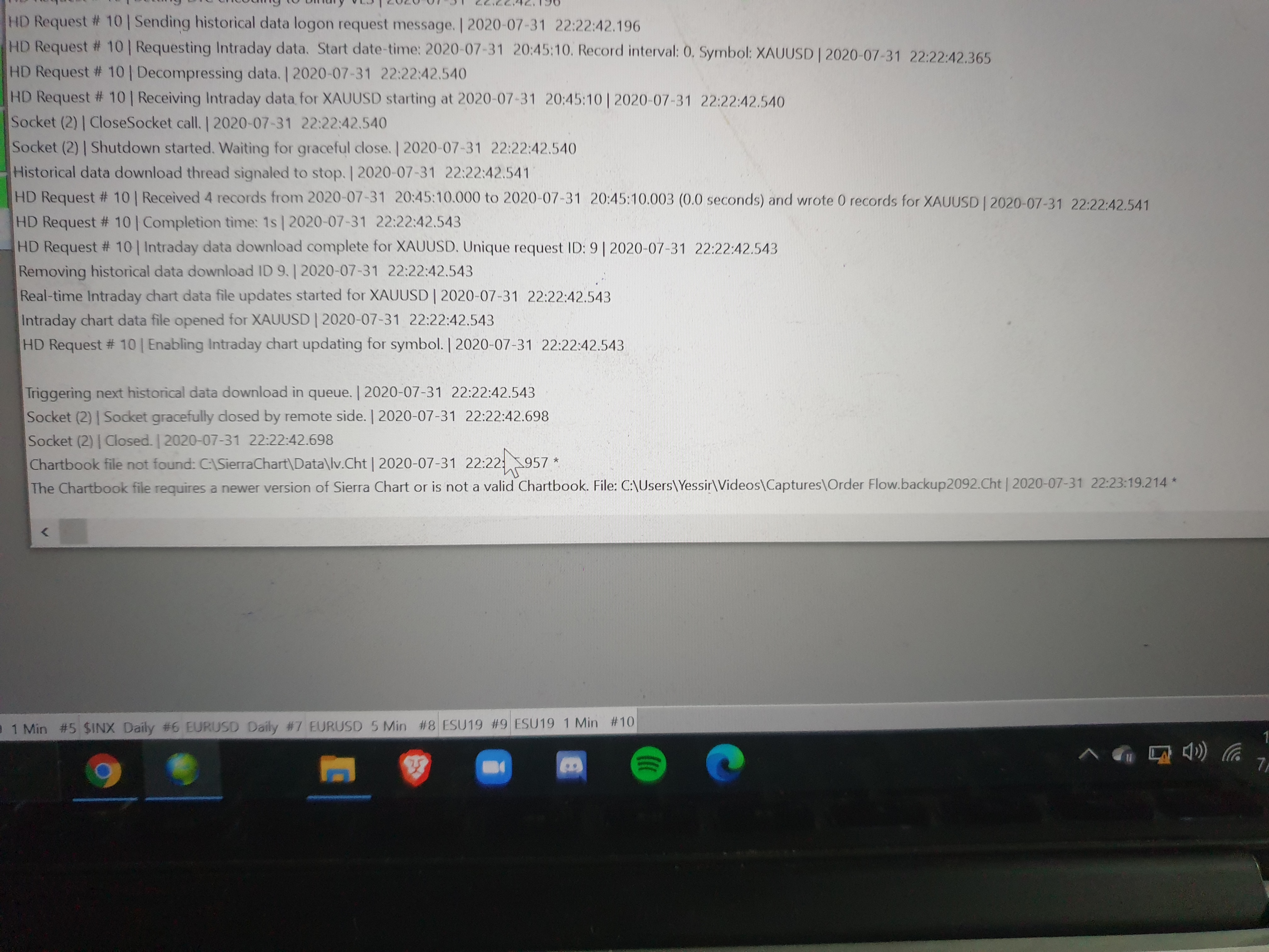

Thank you but i have a problem to open my chartbooks, i did installed new version and yet it cant open the error message is in the picture.
Note: i had no problem with chartbook openning during time before.

You should not be trying to open the chartbook named Order Flow.backup2090.Cht. That is a backup file from when you upgraded above version 2092, just in case you wanted to back to a previous version.
You should just be opening the same Chartbook file as previously, which should be named Order Flow.Cht. Refer to the information here regarding opening Chartbooks:
Chartbooks (Workspaces): To Open a Chartbook
