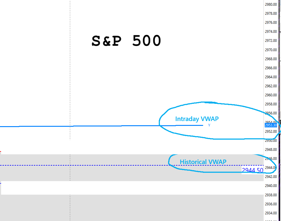

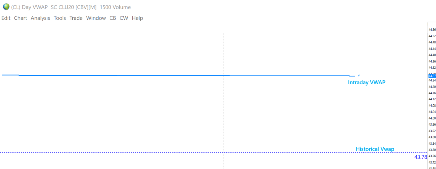

I was analysing VWAPS on various settings and came across a discrepancy that I do not understand.
On the Yearly VWAP I have the "Historical" Chart Data type selected to prevent lag/increase load speed but on other charts I have "Intraday Chart". I also set the Yearly to "Intraday Chart" to inspect if it makes a difference and there seems to be a difference in the price between both Chart Data Types.
I cannot identify the cause of this. Can you please advise?

[2020-07-23 19:46:02]
Refer to this section and the section following it:
Volume Weighted Average Price (VWAP) with Standard Deviation Lines: Differences Between VWAP and Standard Deviation Lines On Different Timeframe Bars

[2020-07-24 15:50:14]
Frostation - Posts: 16
Thank you for your response. This makes a lot of sense. Is it possible to have the VWAP line for the Yearly to be visible on the Intraday chart without having to perform manual drawings?
[2020-07-24 18:46:59]
Refer to the information here:
Study/Price Overlay Study
